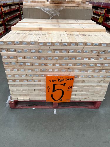

Hello, I am trying to understand the text on the pine wood I bought from local bunnings. Is this suitable for outdoor use? What does AS/NZS 1740 means? My Google-Fu has failed me...

According to https://qtimber.daf.qld.gov.au/guides/strength-groups-and-stress-grades F5 can be used in place of MGP10 so is structural grade timber, it's hard to tell from the photo if it's treated or not, to me it looks clear ie not treated. Outside use should be H3 (above ground outside) or H4 (in ground outside), does it mention either on your receipt? AS/NZS1748 = Timber - Solid - Stress-graded for structural purposes

On the receipt it says Pine Shorts KD UT, 70x35mm 1.1m framesmart. I suppose KD means Kiln-Dried?
Thanks for posting your receipt details @CoolYota, I believe KD UT is Kiln Dried UnTreated. To use this outside, you would need to apply a treatment (Bunnings sells a variety of wood preservatives) and maintain it to make it last out in the elements. It's a nice, sturdy looking timber and would make a great frame for a workbench in a shed etc.
That is spot-on decoding from @twocutekelpies. The letters UT translates to untreated which means that this piece of timber is for interior use only. Would it be possible for you to tell us what you are using it for? If you are using it for exterior use as a form of support it will need to be painted to protect it from the elements. But if you have not drilled or cut into it, I suggest bringing it in and exchanging it for H3-treated framing timber.
