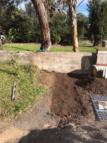

Id just go for a level between the two, use a shovel blade at a low angle and "scrape" horizontaly at the soil/clay use the bit that you scrape off to raise the lower side.
You can see the soil slopes here, I just shaved the high side and used it low side and then tamped it (You could use the end of a timber post to pack it down really or just smack down a paver a few times. )
That way you have an overall reduction of 25mmm but it will be level.
Cheers for the photos @Dave-1,
That would be the best yeah... To actually make it level to start with... but a bit more effort... I'll do a test dig and see how hard it is to dig out the clay... I need to dig out the soil and actually check the incline too... Haven't actually measured that yet...
"Shave" the clay, dont dig it. It is far easier and less work overall if you just scalp the grass and then "shave" the clay. Believe me when I say Ive dug clay and its a pain.
