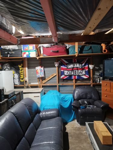

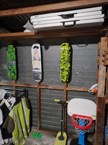

Thanks for your reply, much appreciated, I will try get some photos up soon, I just wanted to insulate the walls for the time being then put some ply wood up as a wall to cover the insulation, just to make it a bit warmer in the winter time.

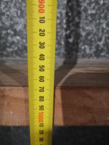

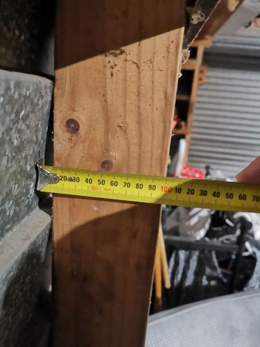

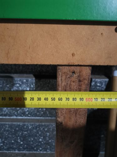

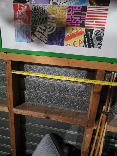

(Here are some photos I've just taken, Measurements are 555mm x 965 x 100, I'd like to do as much of the shed as I can)

After having a look through our range I believe the Earthwool R2.0 90 x 580mm 21.53sqm Thermal Wall Batt 32 Pack would be the best value for your area. Each pack contains 32 batts and will cover an area of 21.53 square meters. Here's a step-by-step D.I.Y article on How to insulate walls which I trust you'll find helpful in the process.
