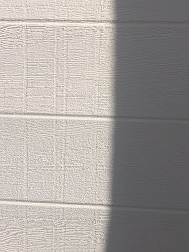

Hi! I am also planning to paint my garage roller door-it’s currently a cream colour but I’d like to have a wood look. Am I able to do a dark base coat then take advantage of the way the metal is imprinted to overlay a lighter brown to create the wood look? I’ve done this before but never on metal surfaces
Quite possibly, @daniT. I'd recommend doing your first coat with a 13mm nap roller to fill all the voids and the second with a 4mm nap foam roller. Do a couple of light coats with the foam roller so as not to fill the lower voids of the timber pattern. Don't lay the coat on too thickly in the first colour and coat with the 13mm nap roller, or you will fill up and diminish the texture.
