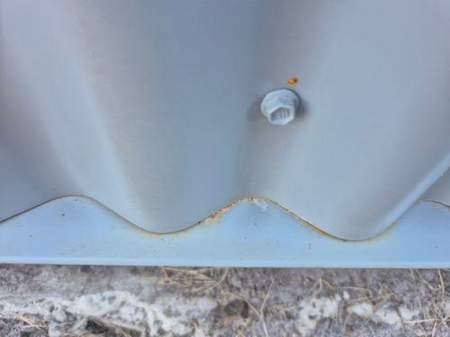

Can someone please recommend a colorbond safe rust converter? There is some swarf in an area I can't get to so want to spray some rust converter there as not much else I can do

Its behind the shed wall and insulation so I can't get to it internally or externally

Cant get the panel off really , it's like this around most of the shed , and they are full colorbond panels and edging, strapping etc. Shed would be over 4m high at peak, so can't even get that high to get edging off

Hi @Taco,
I apologise as I didn't see your image. The rust would likely be isolated to the cut edge. I'd advise painting the rust converter onto the bottom edge with a fine paintbrush. I would use masking tape to cover the painted surface directly next to it to avoid it getting on there. Any that does come in contact with the paint can be immediately wiped off with a wet cloth. Once you've finished, you can seal the edge by painting on a colour-matched paint.
