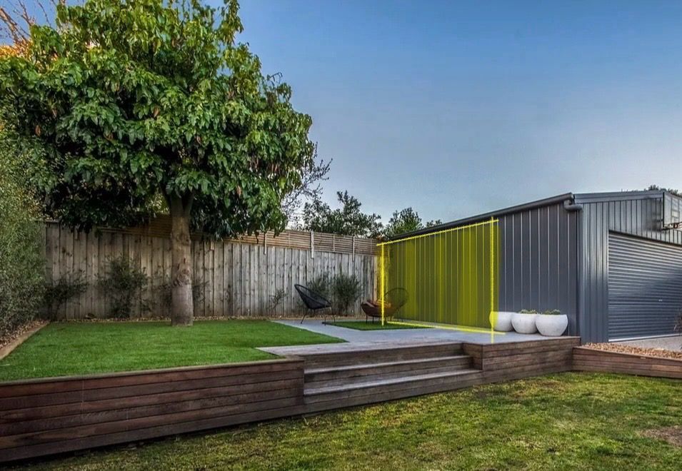

Afternoon @ceedub
Thank you fo the pic ![]()
Idea 1 (tho I like idea 2)
I still like the idea of an oversized box (of the footprint) and then filled with gravel for free drainage. If you want a solid base to the floor then still with the box plus roadbase and then sand plus pavers. That way no ripping up of the concrete you already have.
Idea 2
It dosnt look like you will have to have too high a box to contain the gravel/concrete/pavers. Mmmm you have me thinking. Does the floor have to be level? You could build the shed level, having it sit on the almost the timber you have in play (make sure its treated tho). With the roller door you could add a long triangle wedge that corresponds to the level base of the roller door and the ground as it is now so when the roller door is down it all slots together. You would have to pave that bit of grass area to match but would look least intrusive.
Thanks for the photo @ceedub Albeit a decent rise, long term it will provide a smooth level surface within the shed, easy cleaning with no trip hazard and something solid to fix the shed frame to. It's still the option I would go with
