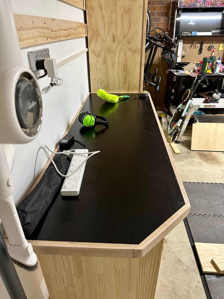

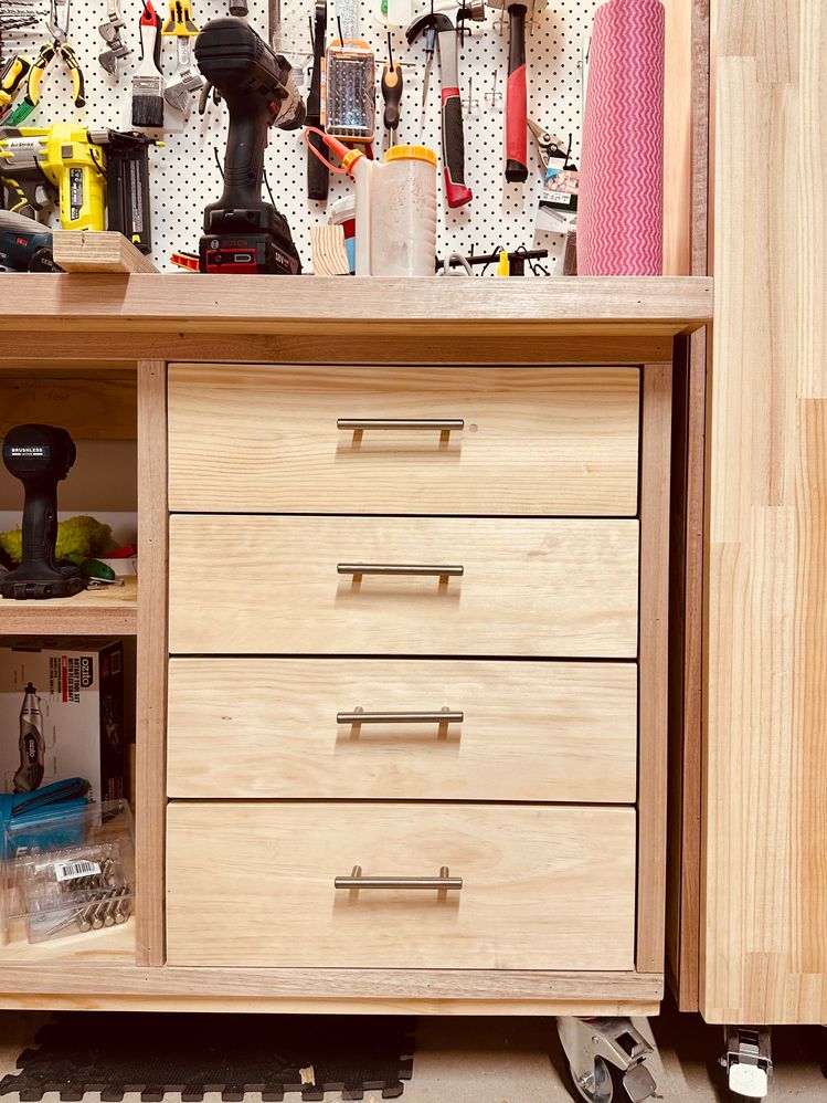

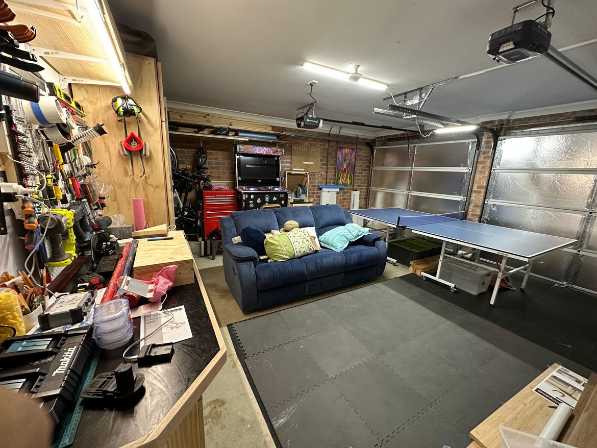

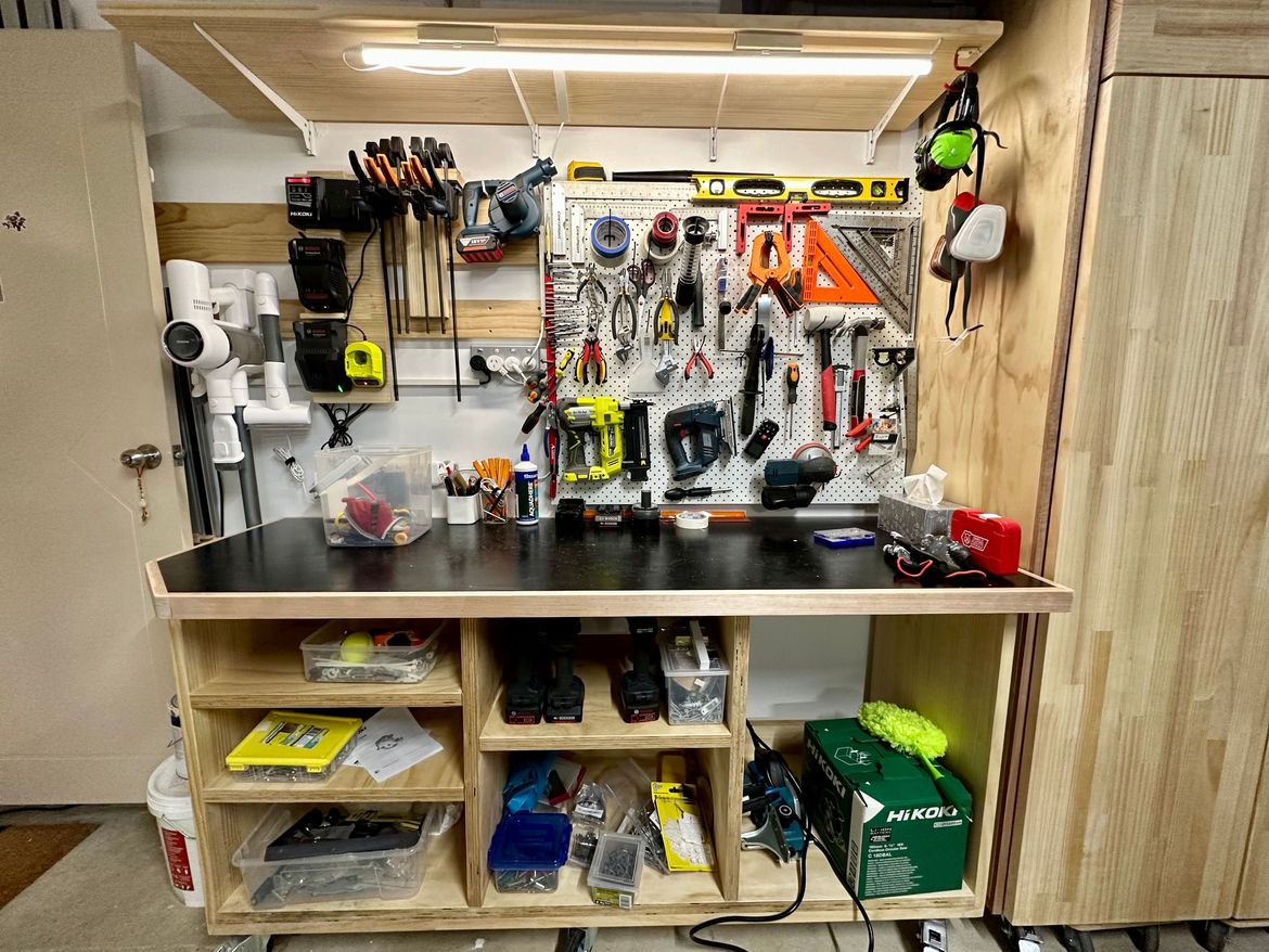

I've been working hard to get my garage up to shape since last year we bought the house - we live in a nice cul-de-sac so we have massive driveway which allows for 2 cars parked side by side or in tandem and still leaves plenty of walk space which means the garage is all mine to play.

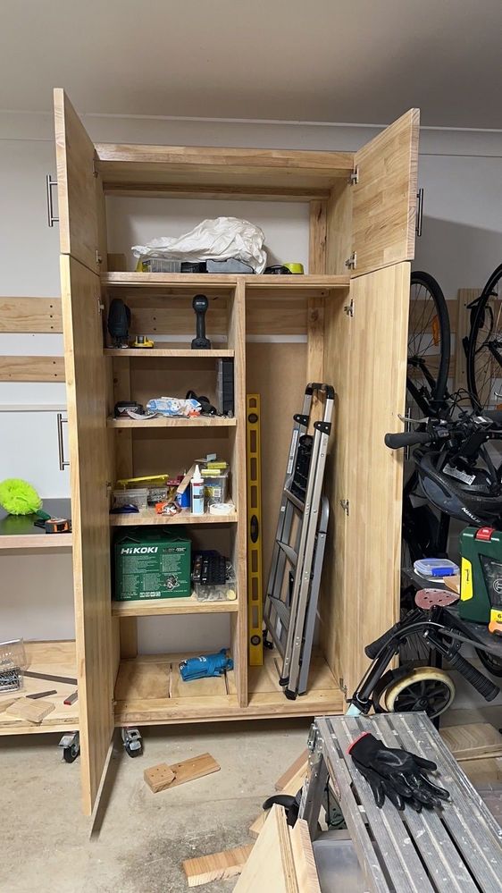

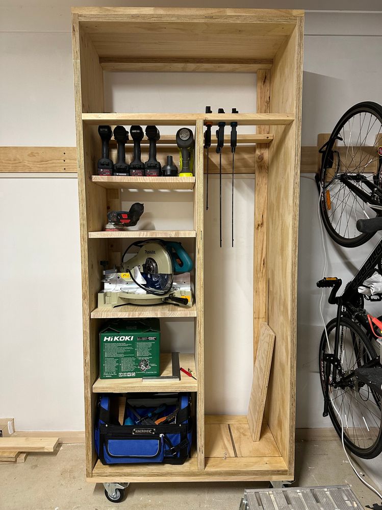

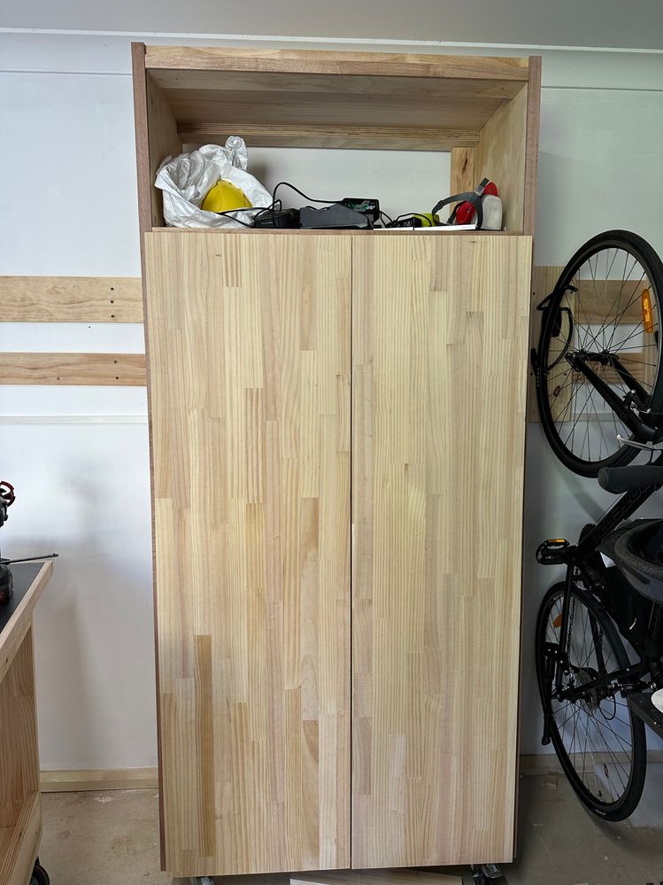

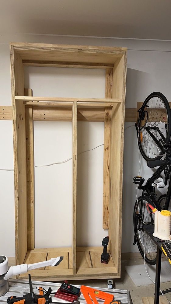

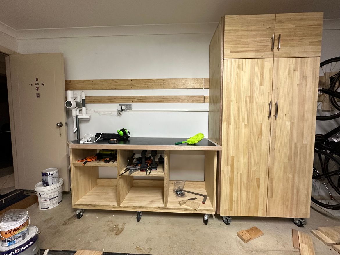

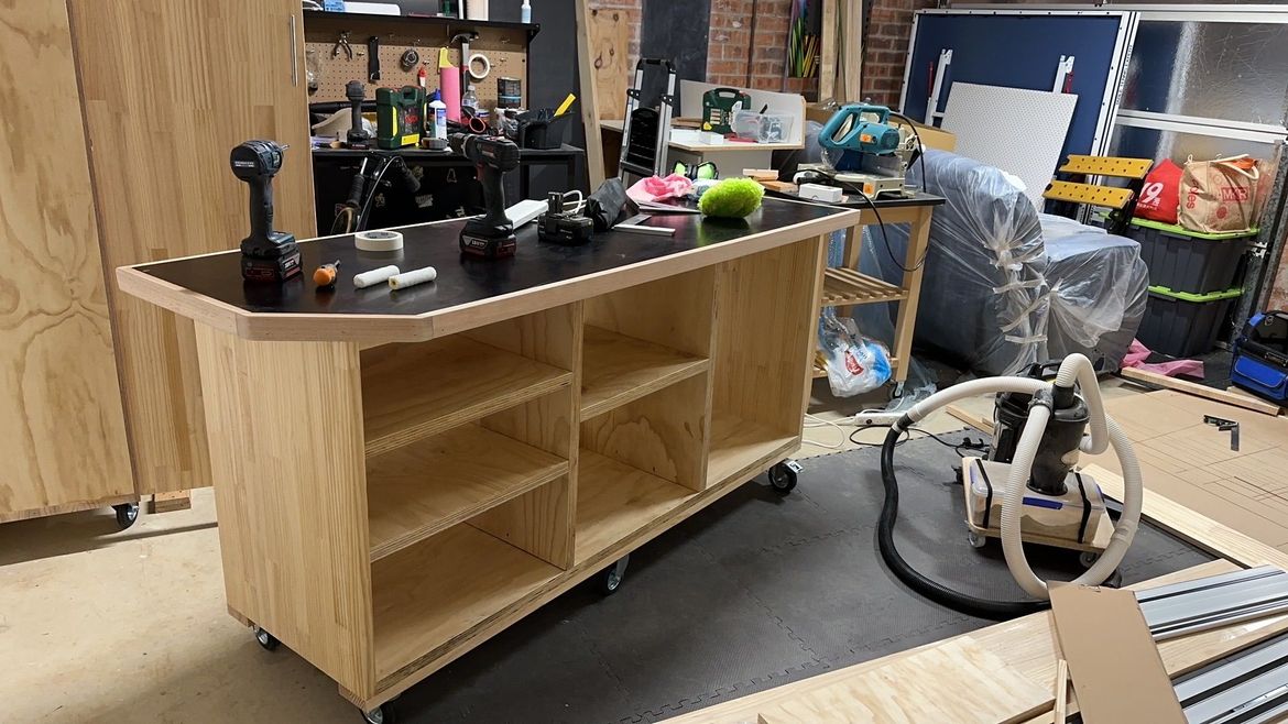

My most recent project is the workbench + 2.2 meter tall cabinet combo, using solid FJ wood panels and 30mm BC grade plywood from Bunnings. I applied hardwood moulding / trimming along the exposed edges and also applied 3 layers of water based varnish, sanded down with 120/240 then a 3000 grit to do a shiny smooth finish. Also chamfered the hard edges using a Makita planer and some 60 grit sandpaper with a Bosch blue random orbital sander.

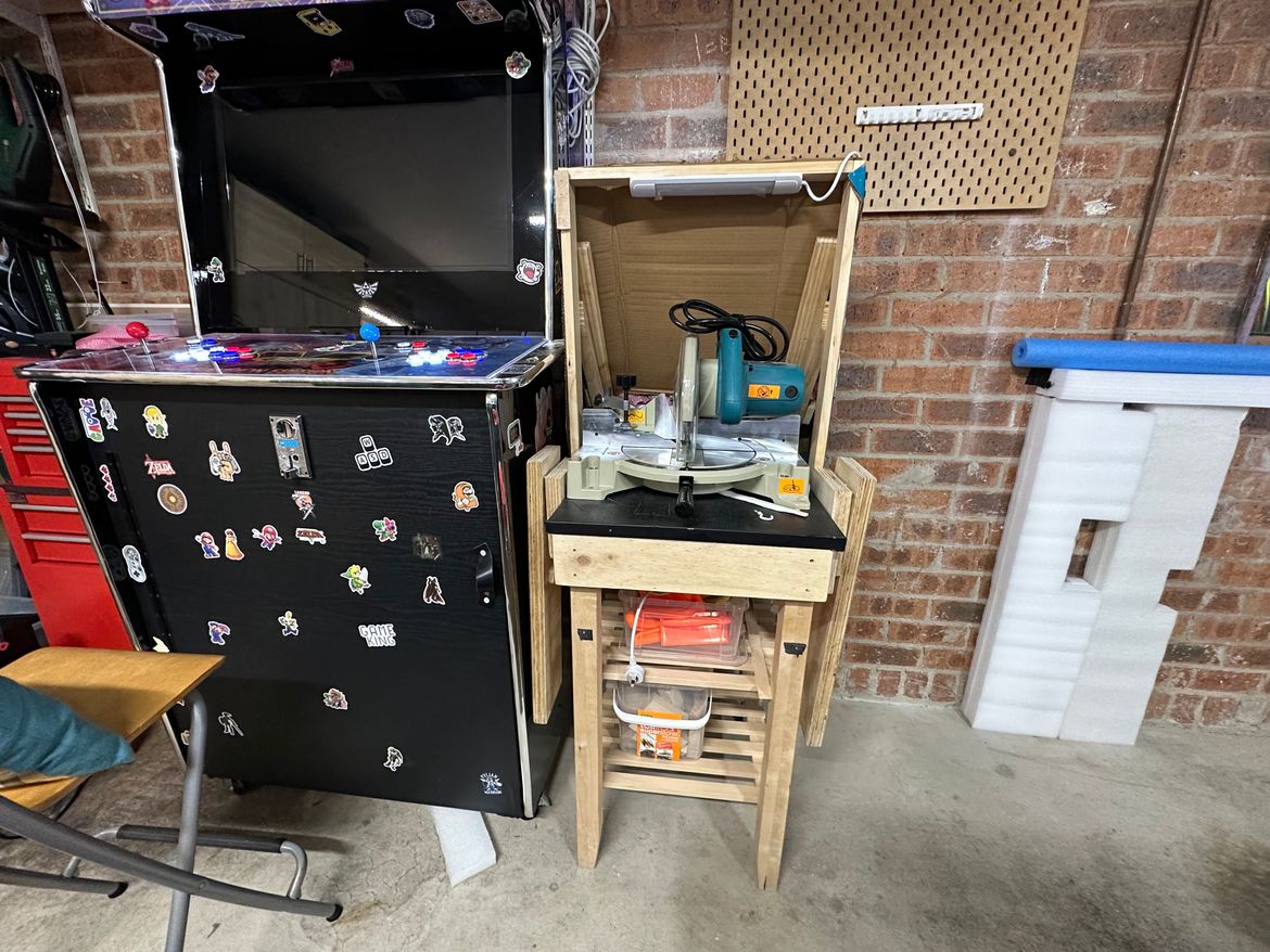

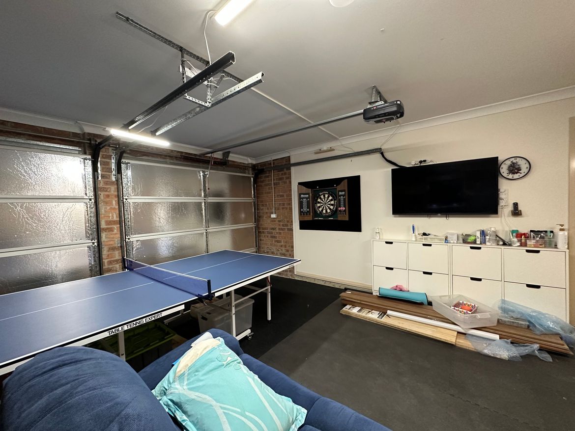

You'll find in the picture also my new arcade cabinet featuring a 32 inch screen, acrylic covered front panel and control panel, took me 6 weekends to finish together with my then 11 year old boy last year. It's also paired with dolphin bar and Wiimote controllers for some lightgun arcade shooting games.

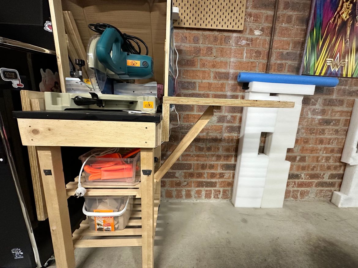

In the process of making these awesome toys and storage, I also made a make-shift drop saw station with awesome dust collection (I built a dust cyclone myself as well for less than 40 bucks), and 2 foldable wings for timber support and precision cutting using a stop block and a clamp.

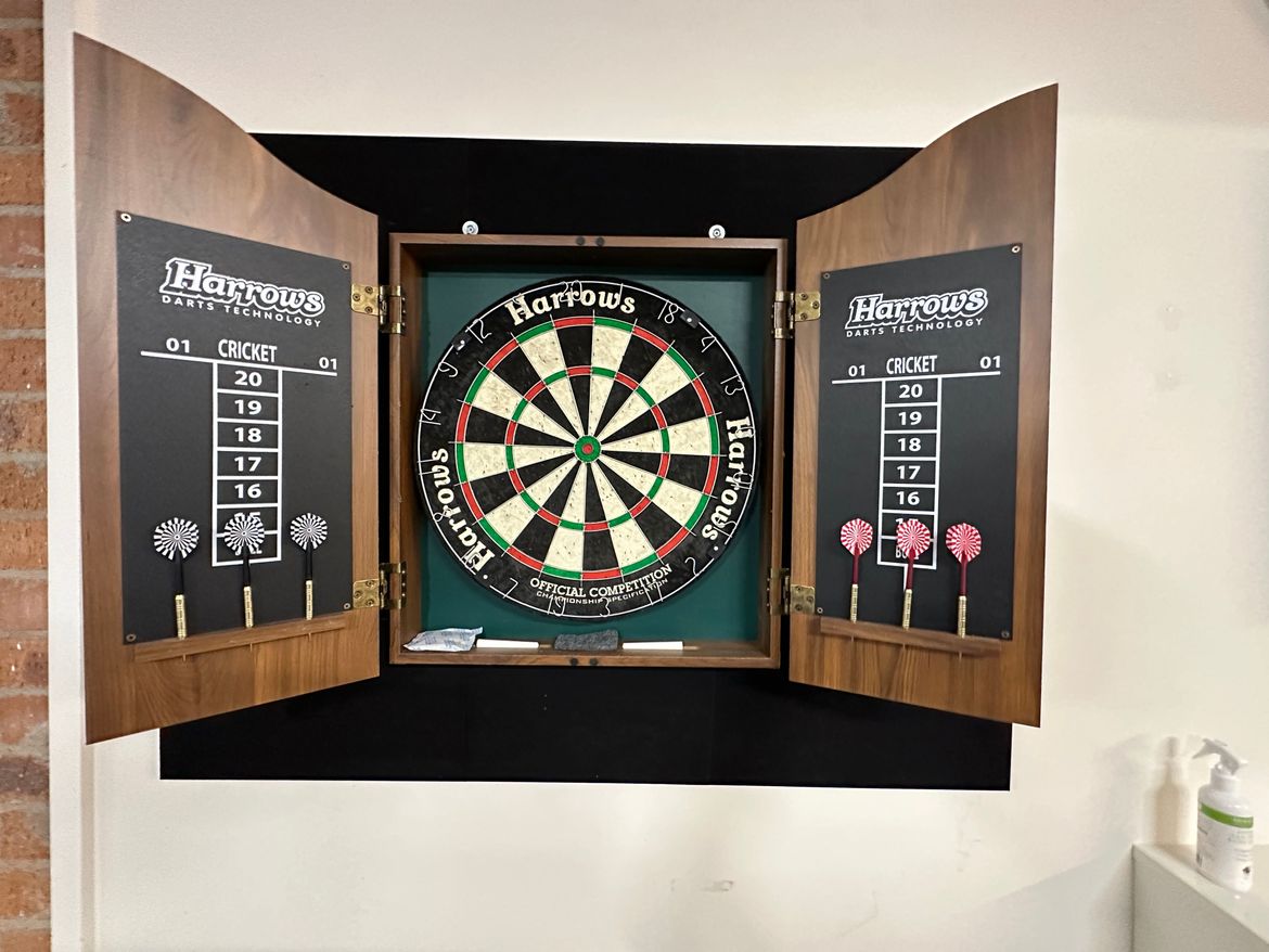

And a dart board that is now practically just a decor cos we got hooked with pingpong recently 😀

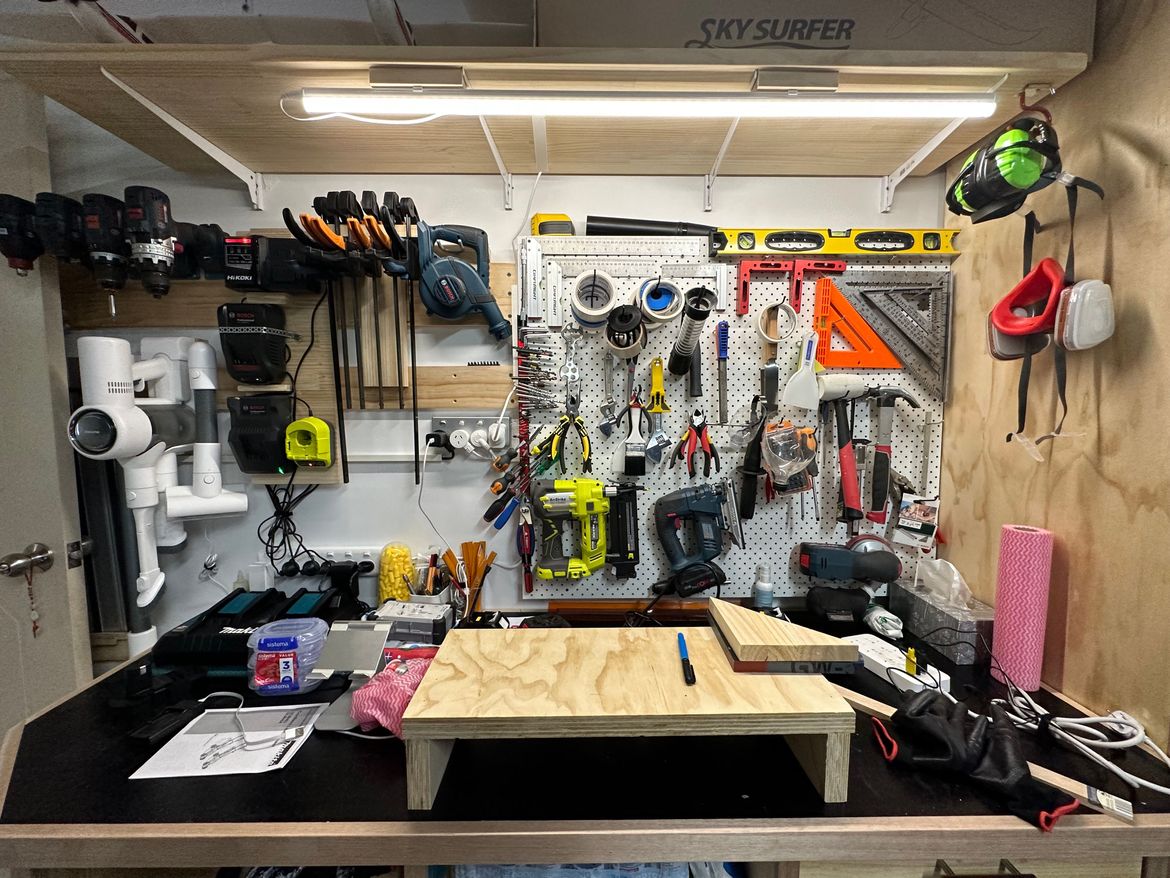

and light is up

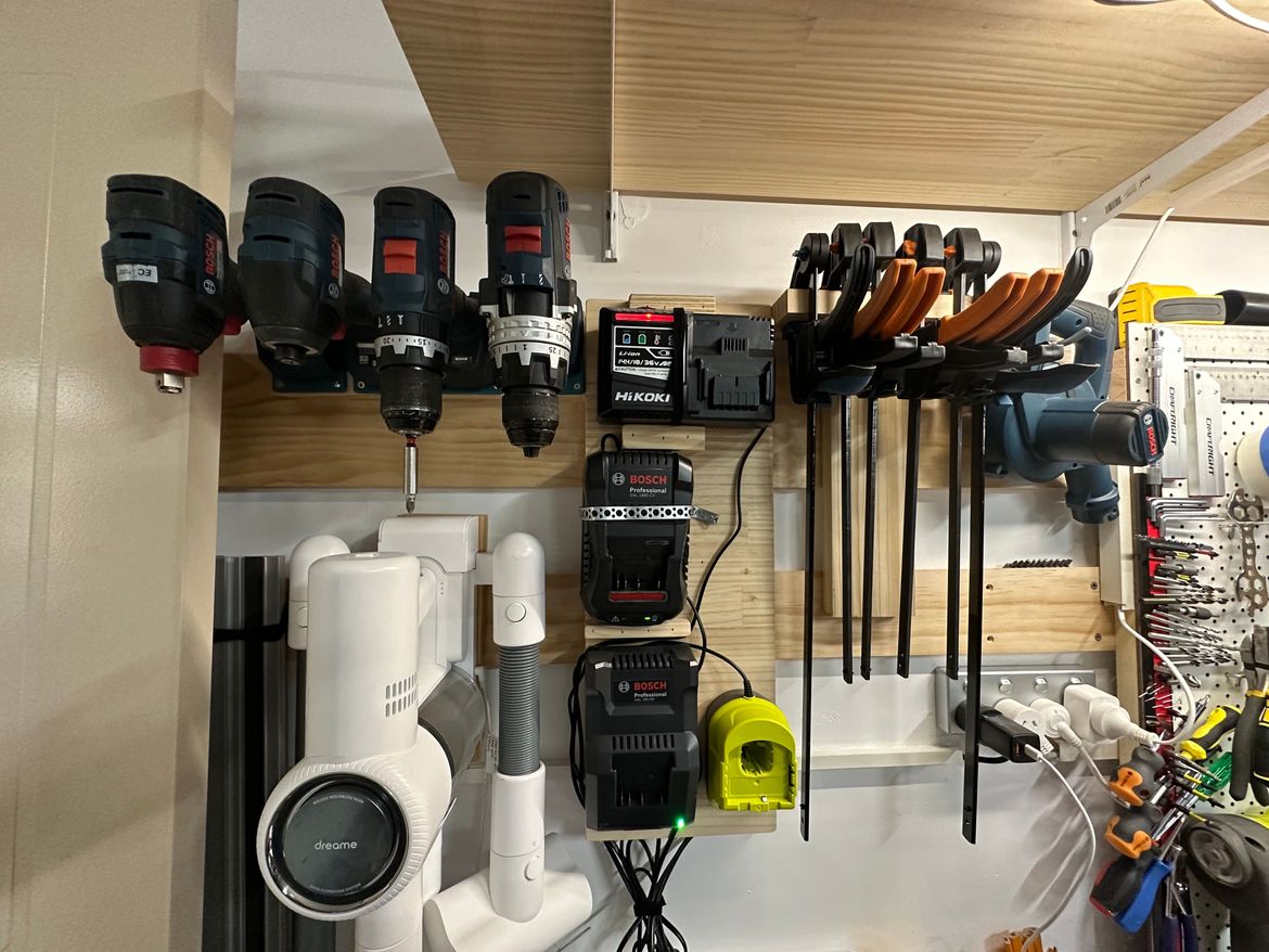

took me and wife half an hour to put up the side panels for the cabinet - it's 21kg each side...carcass is readyshelves are readyworkbench and cabinet side by sidedoors are done!all 4 doors are up!shiny!hard oak edgeplenty of storageready for first round of paintput some brackets for shelvingshelf is up!pegboard combined with French cleat - win-win!and light is updrawers drawersall drawers done!tidied up with the old recliner 3 seater back in positionmake-shift drop saw stationand this bad boy has wings!the arcade that took me 6 weekendsfancy dart board - yet to be usedspacey! with timber for outdoor table (next project, probably for Xmas)added storage for my beloved Bosch blue drills and drivers (you can never have enough drills and drivers can you?)scrap wood? no worries, now I got myself a little laptop stand

Thank you so much for sharing such an awesome and epic man cave makeover. Where do I begin? There are so many noteworthy spots on your build from the magnetic strip that's holding all your drill bits, the dedicated drill holder, and the hand vacuum mount all organized in easy-to-reach locations.
The 30mm timber that you used will last you a long time, and the top shelf that holds your excess timber and other items were very well thought out. I see your arcade cabinet got your 11-year-old's sticker of approval and your drop saw table looks fantastic. Have you thought about a mini fridge and a sandwich press spot in the garage?
