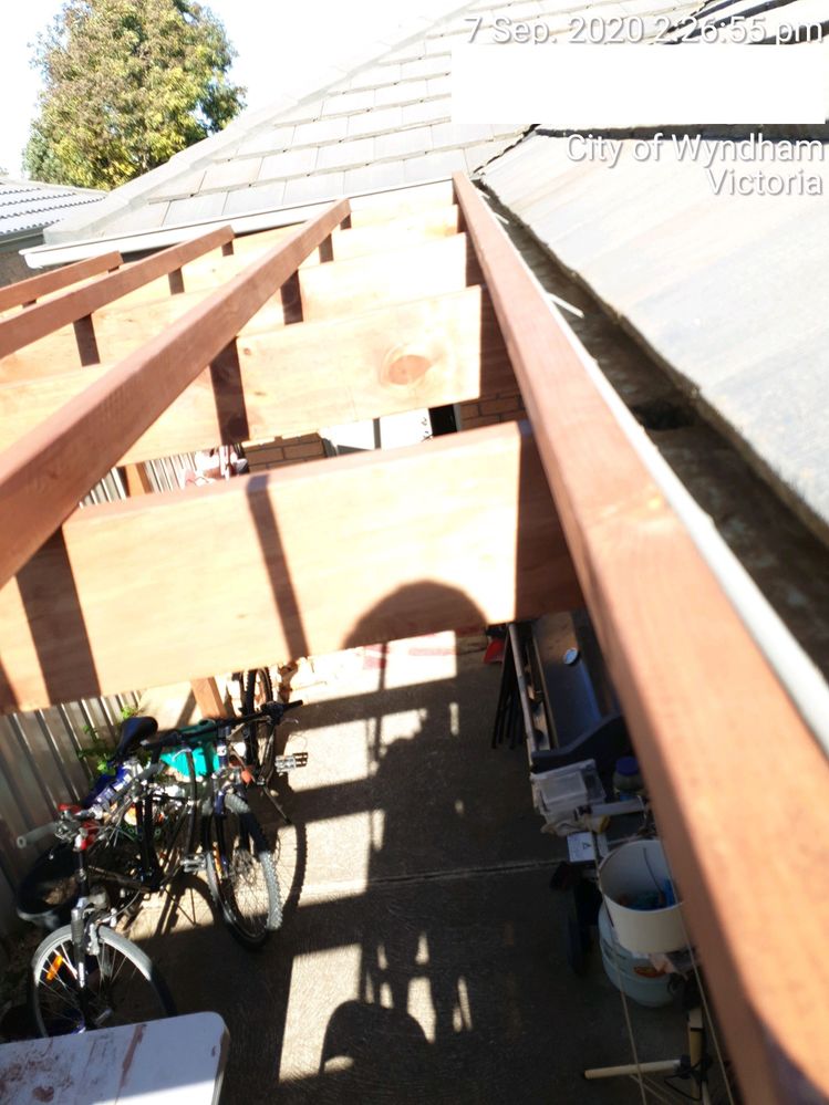

Hi all, am a newbie..i just Would like to put on
roof but wondering what flashing should i use from roof to gutter to avoid leaking???

The type of flashing you use is partly be determined by what type of roofing you are installing. Could you please advise if you are are using polycarbonate or steel and what profile it is. Also, do you have plans on what point you are starting the roofing? Will it be overhanging the gutter or set back from it?

Thanks for the response, yea about that, am gonna use steel zinc corrugated, 12x2.1 long. With two transparent polycarbonate in between. Thinking abiut overhanging it, but not sure, jusr want it to be sealed properly
Thanks and regards Rhone

I'd recommend sandwiching Suntuf Black Corrugated Foam Infill 4 Pack under the sheeting on top of that closest purlin to the gutter. I would also sandwich a piece of Suntuf 127 x 5 x 15cm Clear Corrugated Polycarbonate Wall Flashing on the purlin with the flashing dipping down into the gutter.
You just want to make sure that when there is a high wind that water doesn't get blown under either your sheeting or the roof tiles depending on which way it's coming from.
