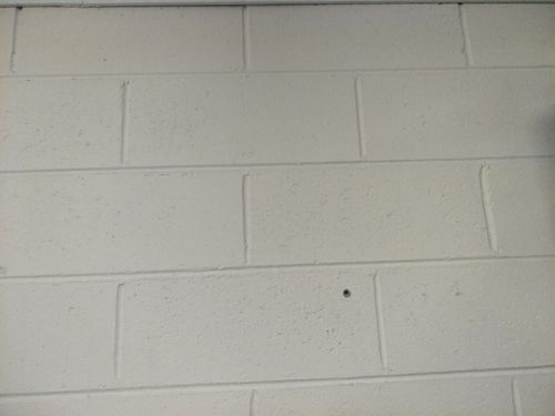

Hi. I want to put up carniya sz25 brackets from bunnings in garage for some shelving space. Its going aganist what i think is cement brick, although not sure. I need help to figure out what type of screw or anchor to use.

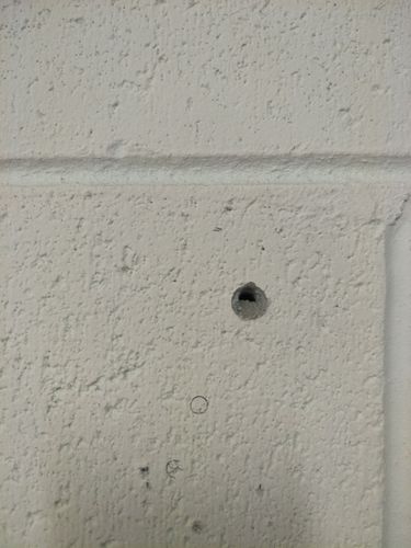

@MitchellMc  hi. What i thought was brick is actually bessner block. How can i put up the shelf brackets.
Re: shelf bracket installation
Hi @lindasjohn,
I could see they were Besser blocks and advised as such. You might have the most success by drilling your holes in the mortar lines or if the location doesn't allow straight into the brick is also fine.
