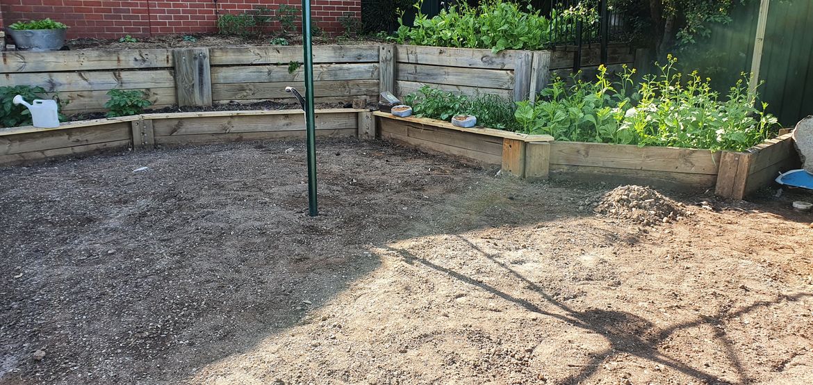

Hi All,

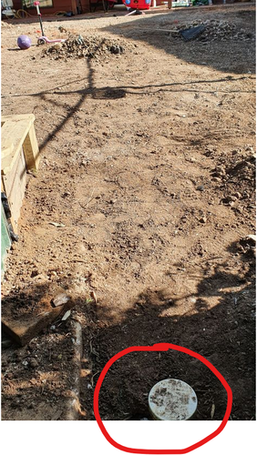

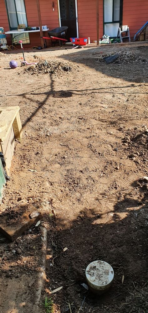

I need a suggestion regarding drainage. I have levelled backyard on my own. approx. 50sqm planning to lay buffalo turf. I am bit concerned about rainwater drainage. I have got garden bed on one side and bungalow on North side. House sitting on elevated land above ground. I can see stromwater inspection outlet near backyard. Now, my question is: it it an good idea to lay Agi pipe around and create stromwater pit near inspection pit and connect all end of agi pipes to that pit ? Please provide me geniune suggestion as I am newbie who love DIY.

Is there any preexisting drainage issues that you are aware of? When it rains heavily does water pool for an extended amount of time in the middle of the yard?
Agricultural line is normally laid to address an issue or prevent one from occurring when you have made changes to landscaping. If you haven't experienced any issues previously then I don't believe there is any reason to be worried about rainwater drainage. However, since you have levelled the yard and have not yet laid turf it would be a good time to install some now. You might like to lay a perimeter around the intended grassed area and connect the run back to a stormwater pit. This would assist if any future issues arise.

Thank you very much for your valuable feedback @Grub80, I think I will install a storm water pit and connect Agi pipe to Storm water pit and then to drainage. I am still confused whether I am allowed to connect this to drainage pipe which is connected to council sewer pipe ? Please suggest me. @MitchellMc @Grub80

Thank you @MitchellMc , but I am still wondering whether this pipe there is connected to stormwater or  sewage pipe ? Any idea to find out ?

@Amar,
You can take the top off and check to see what water is running down it. If you stick a running hose into your gutter and see water coming through the pipe it is the rainwater system. If you flush the toilet and see water running through this pipe it is connected to the sewer. You might find a sewer pipe doesn't smell particularly great either.
As always if in doubt contact a qualified local plumber who will be able to quickly work it out for you and connect you backyard drainage if it is the correct system.
