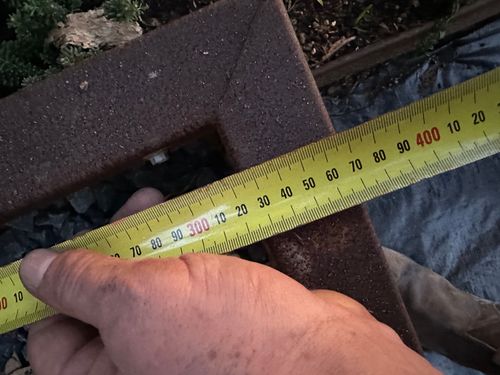

Measuring up

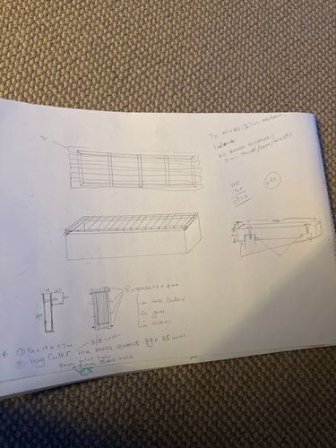

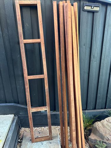

Drawing it up.  I ended up going with a sub-frame design for strength.
Step 3

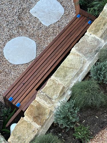

i lay out the cut lengths with spacers to estimate the correct number of lengths for the seat.
Step 4

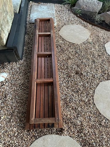

I cut then assembled the sub frame
Step 5

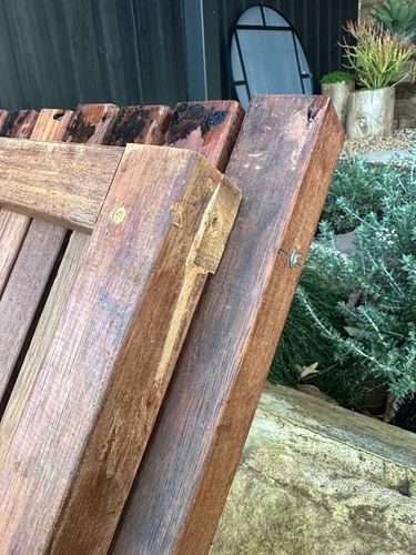

Each lap joint is glued, pre-drilled and then screwed together for additional structural strength.
Step 6
The sub-frame is then attached to the lengths using spacers and the clamps.
Step 7

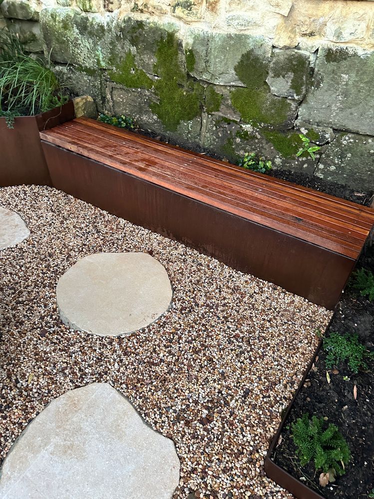

The final bench seat is then sanded and sealer applied.  The seat is then dropped into the planter box which hides the subframe.
