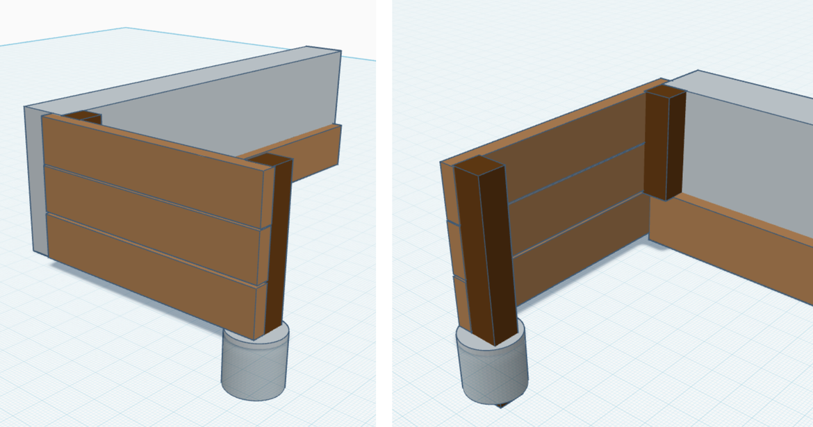

I’d start by cutting back the existing sleeper so it’s flush with the concrete using a handsaw. Given the concrete under the fence, I’d then attach an H4 post directly above the sleeper and bolt it to the side of the concrete with Ankascrews. This will give you a solid mounting point for your other sleepers without needing to create a concrete footer on that side. On the grass side, you can concrete in another H4 post into the ground to provide your second mounting point. From there, the sleepers can be screwed directly into the posts, creating a stable retaining structure. This approach gives you a neat, secure edge for your raised garden bed.
I've created the renderings below to illustrate.
