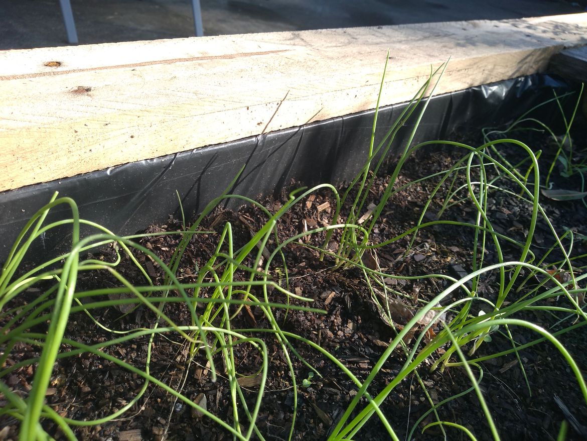

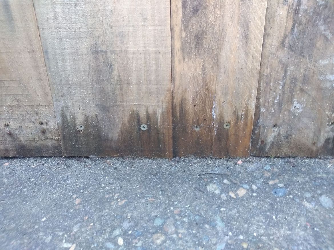

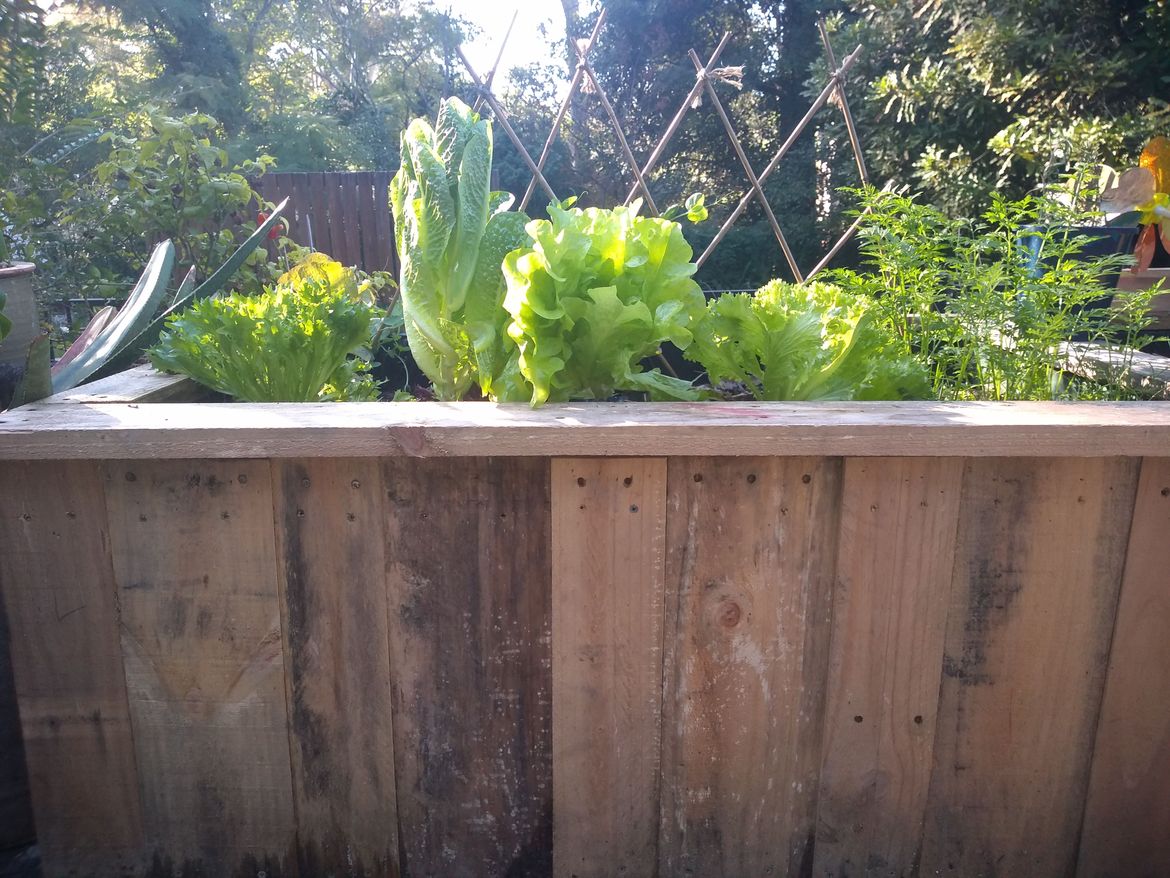

If the pallet wood is untreated pine, then it will have a limited lifespan out in the weather. To extend its lifespan you could use a decking oilexterior paint or prevent it from being in contact with the soil. I've included below some pictures of my own pallet wood garden bed. You can see that I have lined the bed with plastic to prevent the timber being in constant contact with the moist soil. You will need to allow drainage out the bottom so the bed doesn't fill up with water and I simply cut the plastic for that purpose on mine. I've also included a picture of where the timber meets the concrete and you can see it wicking up moisture. This will likely be the first place to start rotting.
I've deliberately not used any type of preservative to see how long pallet timber lasts in this type of application. I estimate that it will be several years before it needs to be replaced and I will be happy if I get 3 years.
