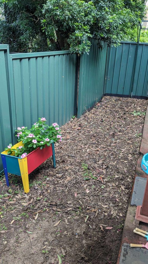

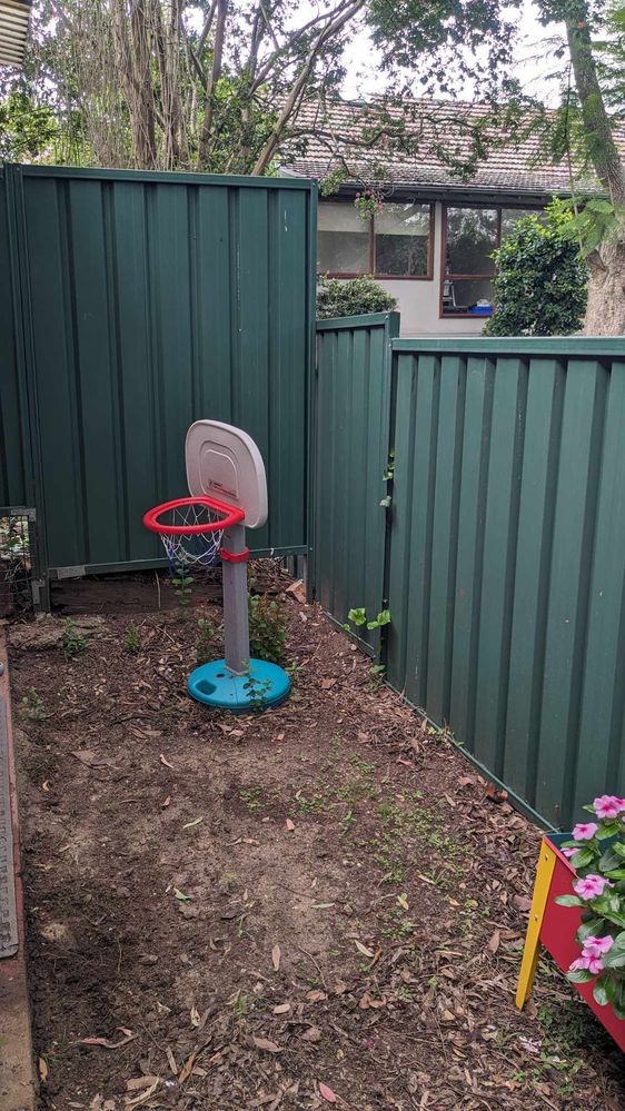

We have a small courtyard with a strip of dirt.
What can we put against the colorbond fence to protect it from the soil? We're hoping to level out the soil, so it's level with the concrete and so we can put in a dichondra lawn.
We were thinking a single line of retaining wall blocks? But would these have to be set down a certain distance from the fence to prevent moisture buildup? Open to other ideas.

With your two photos, the first one looks like the base of the fence is level with the soil in the yard, the second one it looks like the soil has already been put against it? At least the second last panel?
I always worry about weight pushing a fence over long term. I do like @MitchellMc 's suggestion of sleepers and posts for them. I do have another suggestion that will also help with moisture as in it wont retain it. I am thinking of using gabion basket' as there are a range of sizes available. In particular Jack 65 x 30 x 15cm Landscaper's Plant Support Garden Gabion (Just found out that they come in black as well!
You could place these along the fence line, I would suggest to have at least 4cm space between the fence and anything as then your neighbors cant say its causing an issue. If you calculate the height right you could also put a capping stone along the top, I would suggest to use some geotex cloth so the soil dosnt enter into the basket.
Front corner gabion wall Is one of my walls where I used the pre-made baskets. This was the 400 * 400 *800mm size, for you I would be going the smaller size and only one high. This is just to show how easy it is to use
You could still grow your dichondra lawn between the concrete and the blocks with a capping stone if you wished. The water flows freely through the stone filled baskets. So no concern about moisture against the fence panels.
