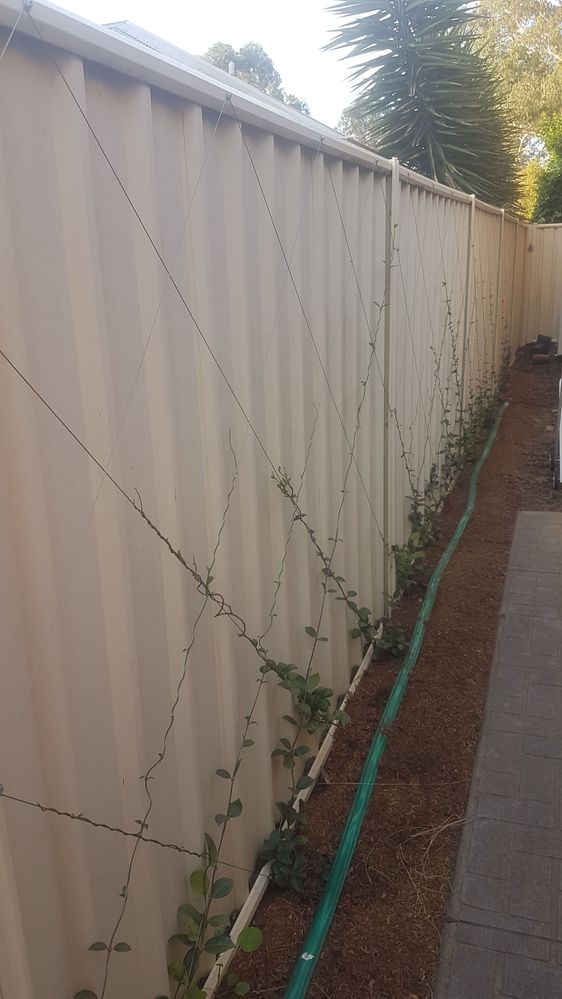

Easy little project at my brother-in-law's place a couple of weeks ago. Took about 5 hours and cost less than $100. Really makes a difference.
The fence is all you can see from one of the bedroom windows, so it needed something to make it less bland. However the fence is very close to the house so we wanted to do something that wouldn't take up too much space.
I made a quick video with a time lapse camera just for fun :smile:
BeforeBeforeAfterAfterAfterAfter
Thanks for checking this out, happy workshopping.
Cheers, Roy

What's the climber that has been planted?

I planted Chinese Jasmine Star because I know they work well in the climate and grow really fast. Added bonus they have a pretty white flower in spring. They were only $5 each too so no complaints.
I actually did an Instructable on this project a couple of weeks ago with a little bit more detail on how it was done.

I've just got to make sure by brother-in-law keeps training them on the cables or they will grow straight up which will look messy.
Cheers, Roy

I went and checked out the climbers yesterday, they've gone crazy! Grown quite a bit in only four weeks. Looks like they've been training them very dilligently too :smile: Another couple of months and the fence will be covered.
Cheers, Roy

Wow, I can see one runner in the pic is almost at the top of the fence, seems it's only been a few weeks??
