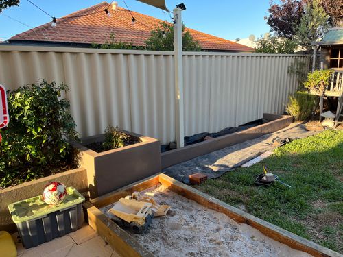

Hey crew, I have a few trellis around my house but none connected directly to the hardie fence. I’m looking to do a similar diamond wire design with wisteria creeper against this fence, just not sure what’s the best approach. Should I build a full frame or can I drill into the top edge of the fence without damaging it?
On a side note how good is this online forum - although I do feel like I’m cheating on my fav local bunnings employees 🤣 so far they’ve helped me build my kids sand pit and this little wall +render to extend my planters.

Although that might be a Hardie branded fence, it also has the distinct oversized corrugation profile of older asbestos fences. If this is an old fence or you are not 100% sure it's just compressed cement you should be wary. You might be well aware of that, but I just wanted to make sure. Even if it is asbestos it looks like it is pretty stable and well bound with that layer of paint.
Given the chance of asbestos, one misplaced hole could expose you to the fibres. I would advise sticking well clear and creating a free-standing framed structure out of 90 x 45mm outdoor framing timber slightly in front of the fence. I've put together a rendering below to give you an idea of how I'd go about it. Either fix the frame into the garden bed with Dynabolts, or you could concrete it into the ground with stirrups. If that capping strip is metal, you can pin the top of the timber frame back to the fence with a few brackets for added rigidity. Make sure to position the brackets in the low of the corrugation to avoid touching the cement sheeting at all. The frame can be painted a cream colour to match your fence, allowing it to blend in.
Let me know what you think and if you have any questions.

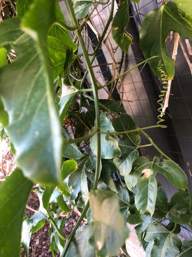

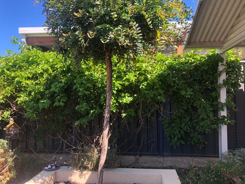

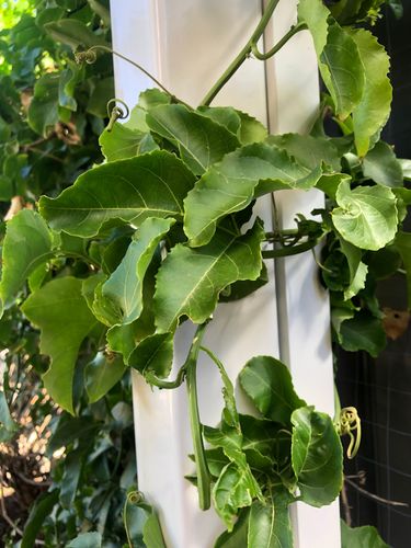

I saw someone ask if you could do this with passion fruit so thought I’d make an account to upload pics of mine. No you couldn’t because it uses tendrils to climb that reach out quite far so it just spreads all over the place if you look at the pics you’ll see the little spiralling arms it grows to latch on to things it would be better to use jasmine as the actual plant twines itself around the support as it grows so a lot more trainable I’ll post pics of my jasmine

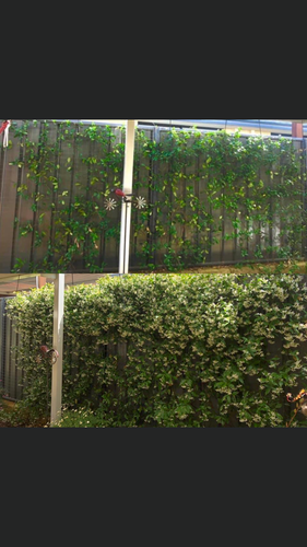

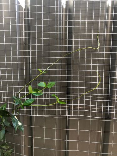

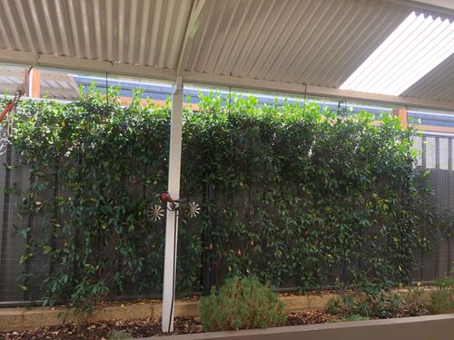

this is the jasmine I have it twines through the flower mesh and it easier to direct for the wire idea on this post, the passion fruit it just super grabby with its little arms it’s got a mind of it’s own.
I saw someone ask about the flower mesh on here and it just depends on if you want the pattern or full coverage I feel like if you did use wire and not train / maintain a pattern you’d get full coverage and it would be cheaper and also less ugly while you wait it looks good now but waiting for them to fill out you have to put up with a big eye sore.
my method was dodgy I wouldn’t do it again I just used liquid nails to whack wood on the fence then stapled the flower mesh it’s not that strong especially for my passion fruit it’s heavier and when it bears fruit the mesh struggles a couple of the bits of wood have come away from the fence lol
The mesh could be good if you installed posts and attached it. My method meant there was a really big space between the fence panels with no support.
