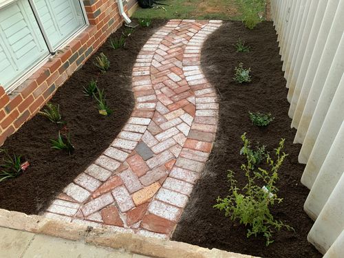

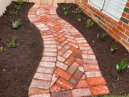

Here is a garden path I built using recycled heritage pavers for a big landscaping job we did in Fremantle. This was actually quite a technical path to build due to the curves in its design but I am super stoked with how it turned out.

Great job as always @Yorky88. Watch out for questions from community members on how to replicate those beautiful curves!

Nice path @Yorky88 , i always love doing curves with paving and brickwork , always wander why i punish myself but the finished product is worth it, i think i can see a straight bit!

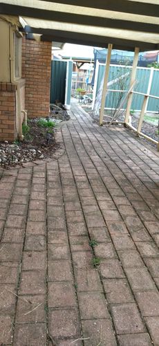

I have paving in my backyards, but it sinks and uneven. The paver
is cracked as well. It is a old house. I want to remove all pave and redo new paver. But I am still worrring it will come back to same situation again? Any idea for the paver base?
Re: Curved garden path using heritage pavers
Hi @Fatsquare,
To prevent paving sinking, you must prepare the base properly with the correct mediums. Have a look at this article on How to lay paving for a path. To get the best results, you should use a compacted roadbase and then compacted paving sand on top of it. Since you've experienced subsidence issues already, I'd encourage you to hire a plate compactor to ensure your base is thoroughly compressed.
If you spend the time on the base, it will ensure you don't see issues in the future. Also, if you gave those pavers a thorough cleaning with a high-pressure washer and cleaning solution, they might be nice enough to re-use.
