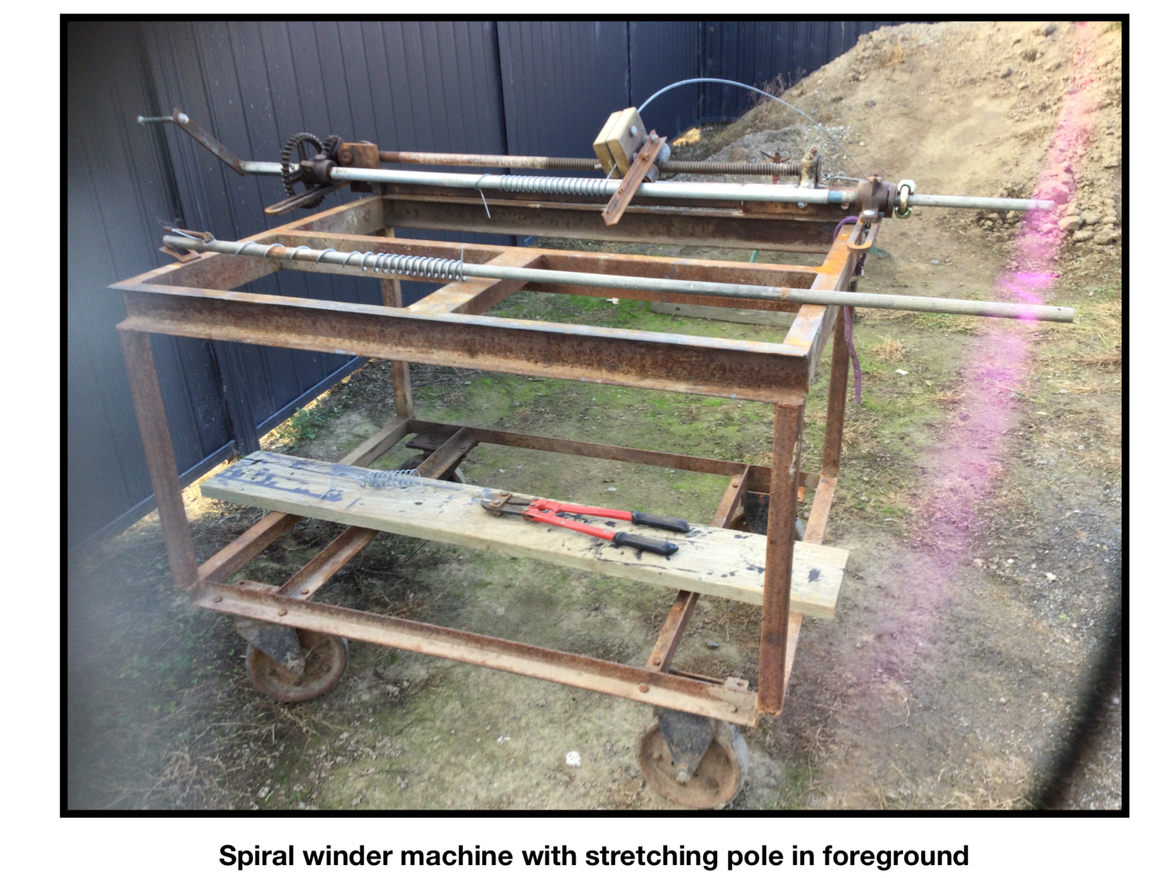

I wanted to build my own gabion fence (35 metres wide x 975mm high x 525mm deep) starting from scratch. I wanted it to be an artisan project, so I built my own spiral winder from parts of machinery I had lying around the farm. The cogs came from a Massey Harris seed drill, and I used a length of acme thread as I wanted the spirals to be even, consistent and regular to make them easier to wind onto the mesh. I used hog rings to hold the mesh together prior to winding the spirals.
If building your own, it is important to remember that the lead shaft needs to turn a bit faster than the winding shaft so that the carrier arm moves at least the thickness diameter of the wire per revolution. I used 3.15mm fencing wire. Looking at the figures there was a 2:1 ratio involved, and I would use 3/4" acme 6 TPI thread if purchasing a length. If using round bar for the winding shaft and stretching pole I would use 25mm and 20mm respectively as this would still give a 5mm differential to allow the coil to stretch.
I was fortunate enough that everything I had, worked and gave me approximately 1 to 1.5 turns per 75mm mesh square. There were no mathematical calculations involved apart from the number of turns required!

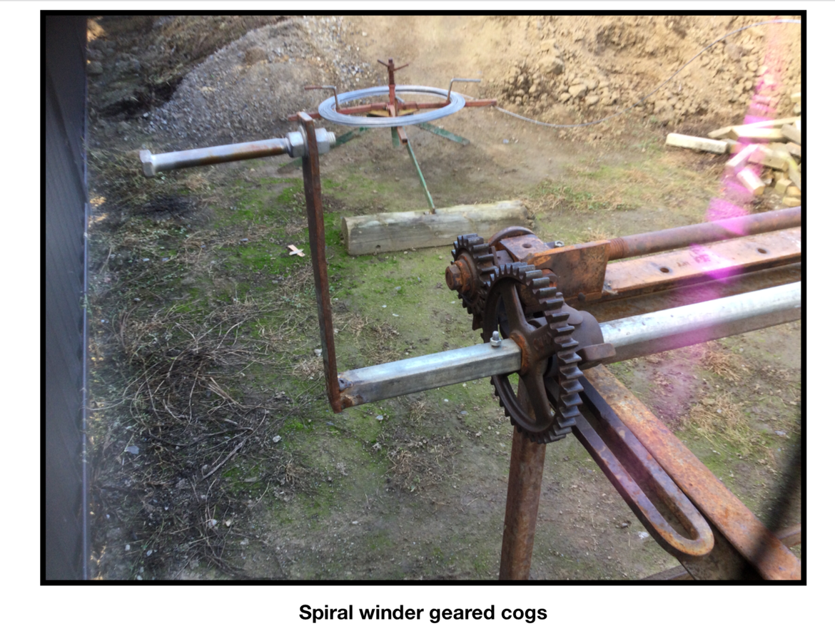

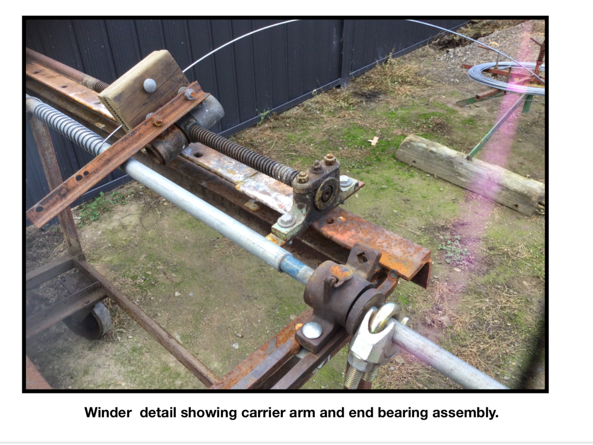

On the lead shaft (acme thread) I mounted the small cog and on the winding shaft, the large cog. On the acme thread nut I mounted a carrier arm with some wooden blocks to provide some tension on the wire without damaging the galvanizing. In effect, this acted like a lead screw on a lathe, as I turned the handle it would carry the wire along.
I threaded the wire from the coil through the wooden blocks (only loosely tightened), over the winding shaft (27mm OD) and then around onto the hook, leaving a 100mm "handle" which is used to screw the spiral onto the mesh. For every 50mm length of spiral that I required I gave the handle 1 turn, (i.e., 1000mm = 20 turns). When I reached the desired number of turns, I cut the wire leaving a tail on it.

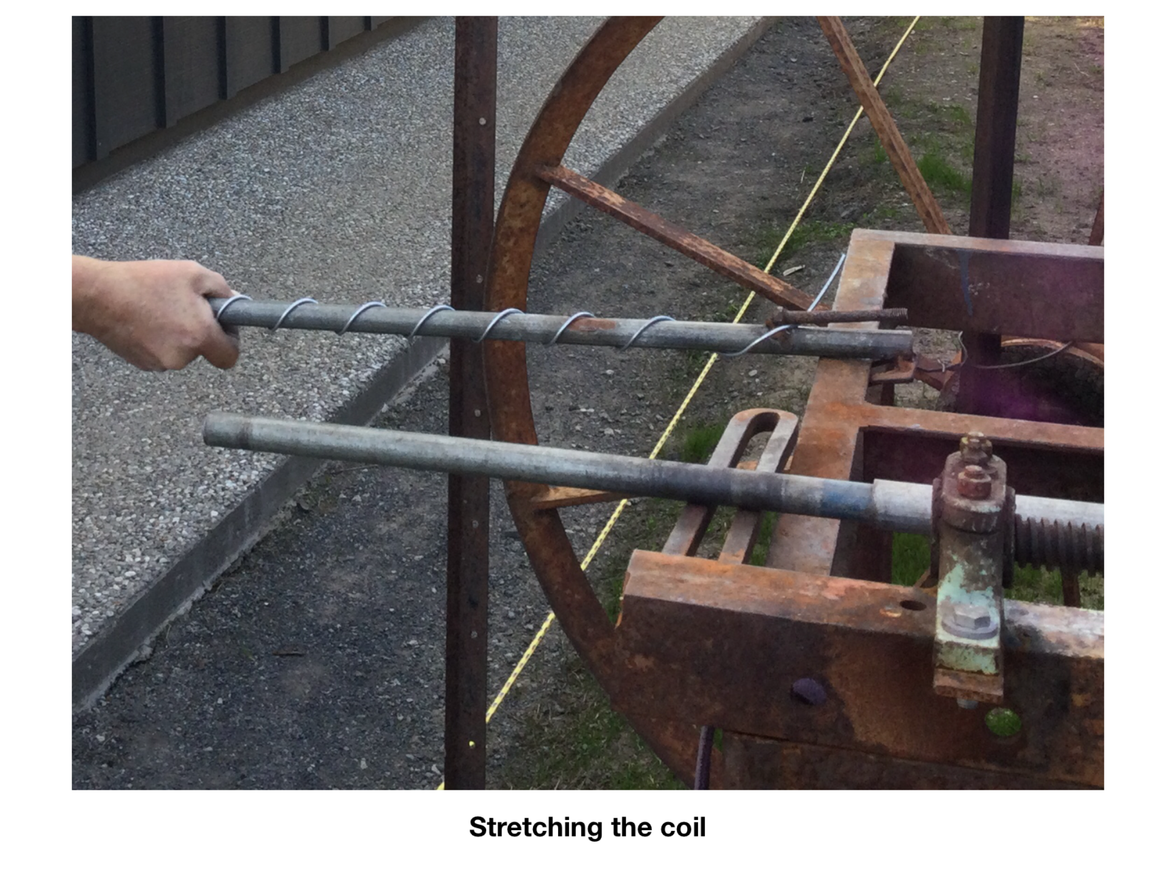

I then took apart the end bearing assembly and removed the coil and put it onto the s-t-r-e-t-c-h-i-n-g pole (22mm OD) which I hooked onto my work-bench and pulled it as far as I was able. This gave the spiral evenly spaced, consistent diameter and regular turns. I then removed the spiral from the stretching pole and tweaked the tail a little so that it would lead smoothly onto the mesh.

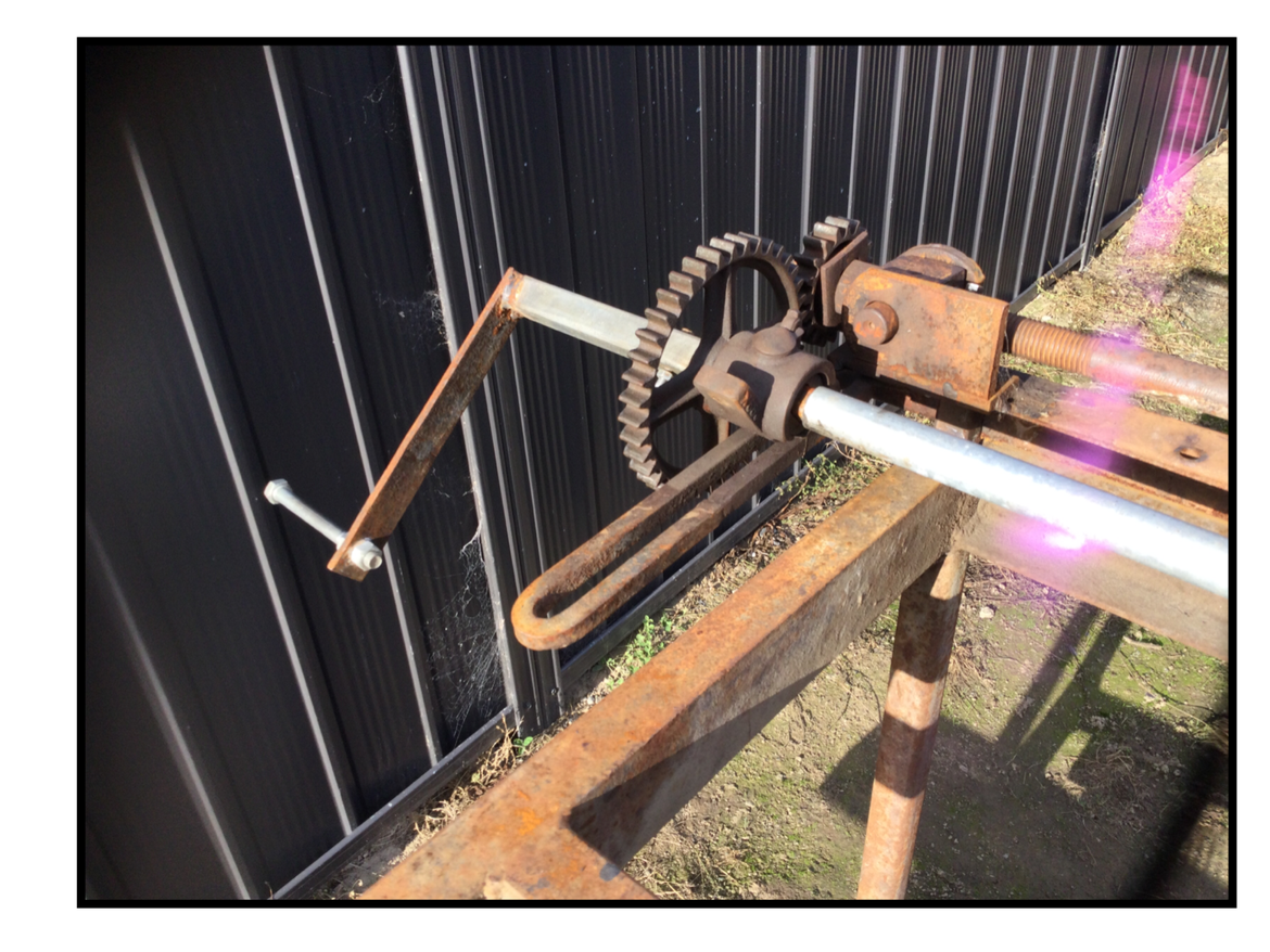

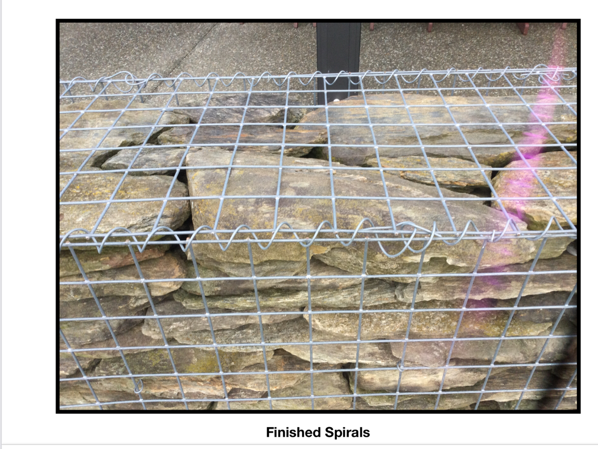

Using the handle I then wound the spiral onto the mesh which I did with ease.

Hello Tyro, I mentioned about having the second bearing/ housing along near the hook on the non-wire side but I ran out of space to explain why I made mine as you see it.
The reason why was because all my bits and pieces were a “sloppy” fit so l supported the end of the winding shaft to avoid placing strain on the 2 gears (they were only made of cast iron) and when the “pull” of the wire came on when winding it may have deviated the shaft enough to break the teeth of the cogs.
If obtaining gears and proper fitting shafts and bearings you may avoid this happening otherwise you will have to mount your bearing at the end of the winding shaft like I did.
Some of my so called “bearings” were really only shaft supports from a former life that were loose fitting. Some sort of “shaft support” maybe cheaper than bearings and pillow block housings as everything is not turning fast.
