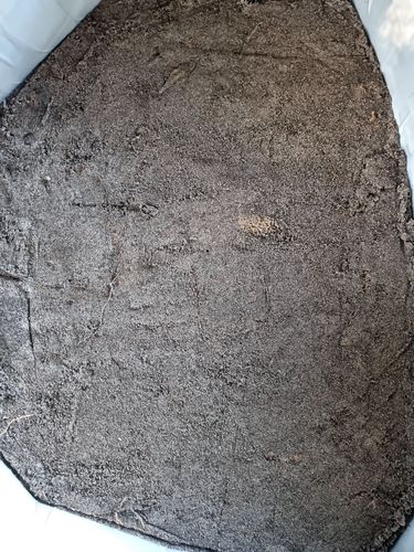

Prepare the area. I placed mine under a the tree in a bare dirt patch so there wasn't too much prep for me although I did flatten and compact the ground with a homemade tamper. You may also need to use sand or gravel here although I didn't my soil is quite sandy.

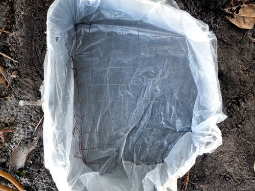

Place a template in the shape you are wanting. Cut a piece of the plastic drop sheet and lay inside and peg template down. Cut chicken wire to size and place inside.

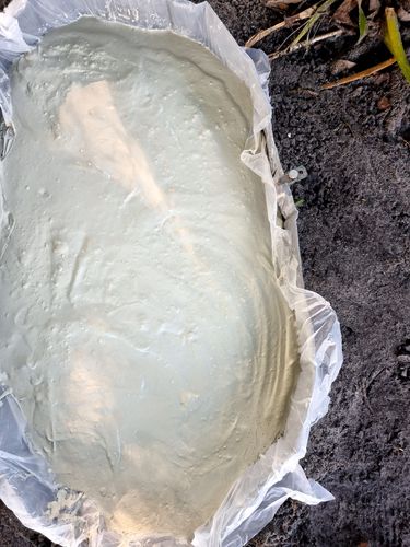

Mix cement as per instructions on bag. Depending on your drill you can buy a mixer attachment or you can just mix by hand. Pour cement and level the best you can, remember you want them to look natural so I did this by hand and didn't make it too perfect.

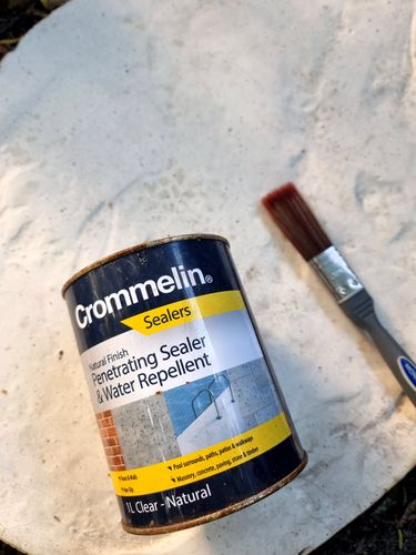

Step 5
After waiting a week take the template away, give the top & edges a light sand and seal.

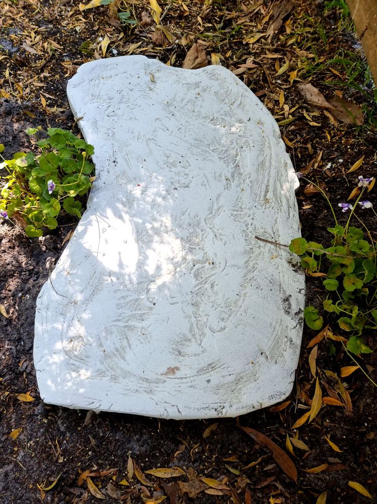

Yes working out how to do the form work was the longest part of the process. I had been researching how to make concrete steeping stones for a while and it seamed all the form work I had seen was too structured or from a material I couldn't find in australia/order online. I even looked into if I could use garden edging but again it gave me less opportunity to make them a unique shape which I think makes them look more natural. I remember thinking cardboard would be perfect but it would get wet and break from the cement, that's when i come up with the idea to cover it in duct tape.
I made one at first and tested it and it turned out way better than I expected (pictured below), so I got stuck into making more and I now have about 15 in total.

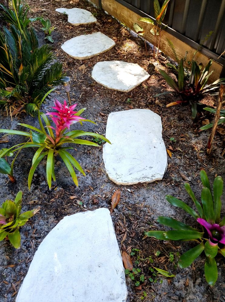

@Herrenovacation what a great idea!
The white stepping stones and colour pop of the bromeliads looks great. You will have to share an updated image once the native vilot grows out.

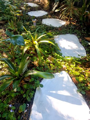

Native vilot has taken off now, every so often I touch up the stepping stones with lime wash to make them look fresh & white again as some of them discoloured from the tannins in the leaves.
Still so happy with the outcome, exactly what I wanted for a fraction of the cost.

Hi @Herrenovacation,
Having had time to settle into the environment, they still look fantastic.
A quick touch-up with your lime wash from time-to-time will keep them looking fabulous for years to come.
