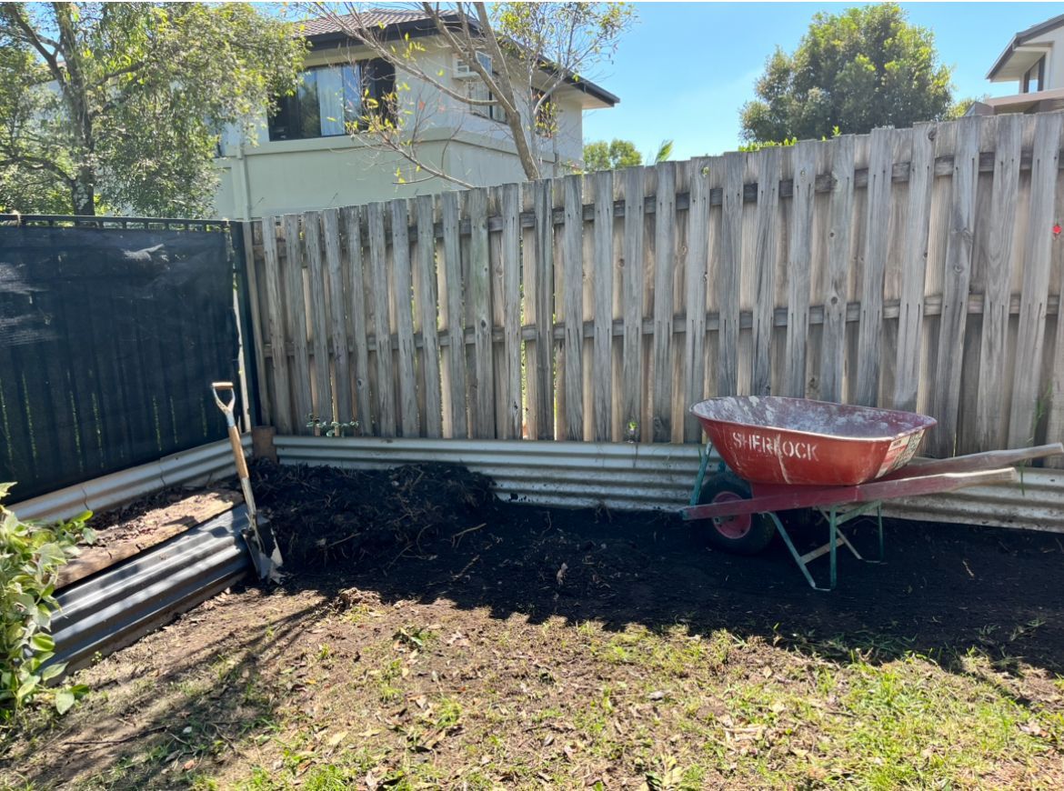

Before digging out existing plants, and raised gardens.Before digging out existing plants, and raised gardens.Taking it back to basics,Taking it back to basics,Still motivated by the potential,. Our prized pot plats that have remained with us on our rental journey were so close to getting planned to grow without limitations of pots

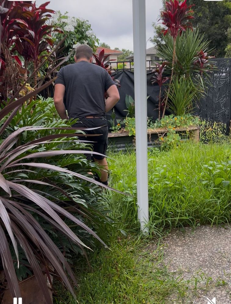

IMG_1521.jpegIts starting to come together !!Its starting to come together !!We removed the existing plants, and shade cloth that wrapped the fence line, this opened up the area and made it feel less restrictive, we wanted to do these plants justice and set there new home up right. this included, plenty of fertiliser and water saver with warmer QLD summer weather on its way

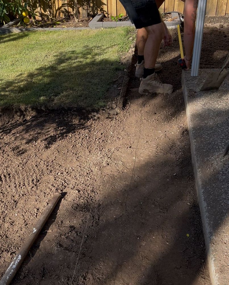

Drip line irrigation set upDrip line irrigation set upstring line marked out the boarder for our brick edging, Drip line water feeder secured around our plants

After mapping out the lay out.After mapping out the lay out.We removed enough of the existing groundWe removed enough of the existing groundto set the foundations for the paversto set the foundations for the paversThis was great to see it all coming together, ensuring the ground was nice and even in surface. there was a lot of going over the same areas multiple times, Using the string line really helped to keep us working within our set areas

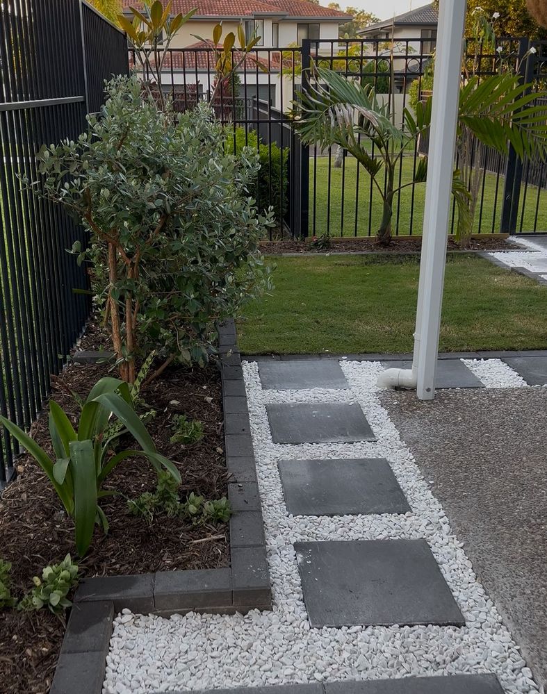

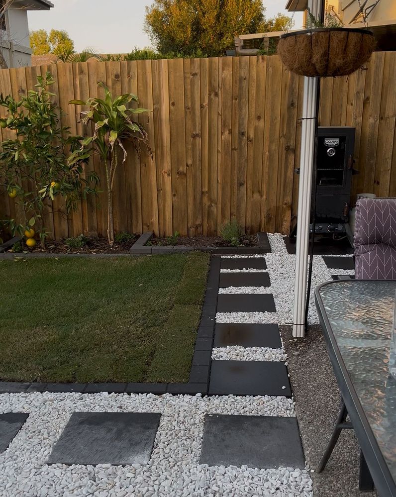

Crusher dust to compact the groundCrusher dust to compact the groundweed mat and concrete to set the pavers in placeweed mat and concrete to set the pavers in placethe finish touch decorative white stonethe finish touch decorative white stoneI learnt something, while it may have been easier to just chuck the pavers down and cover the surrounds in stones, Setting them with concrete, using weed mat ensured long term they stay in place and up keep is minimal

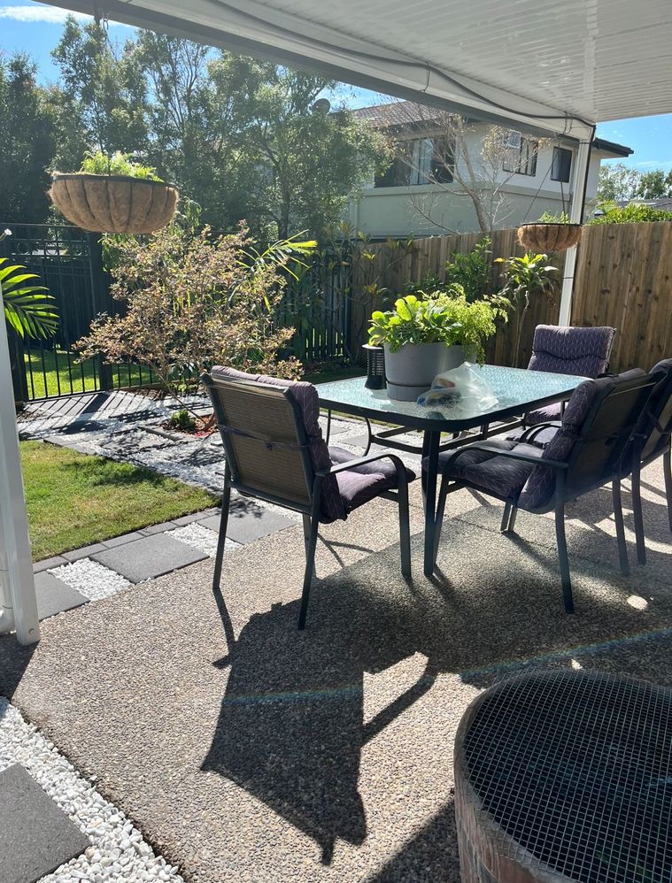

The real pinch me momentThe real pinch me momentwe couldn't be happier with how this turned outwe couldn't be happier with how this turned outwe are obsessedwe are obsessedwe created a perfect little retreatwe created a perfect little retreatyou wouldn't recognise it from first photoyou wouldn't recognise it from first phototo last phototo last photo
