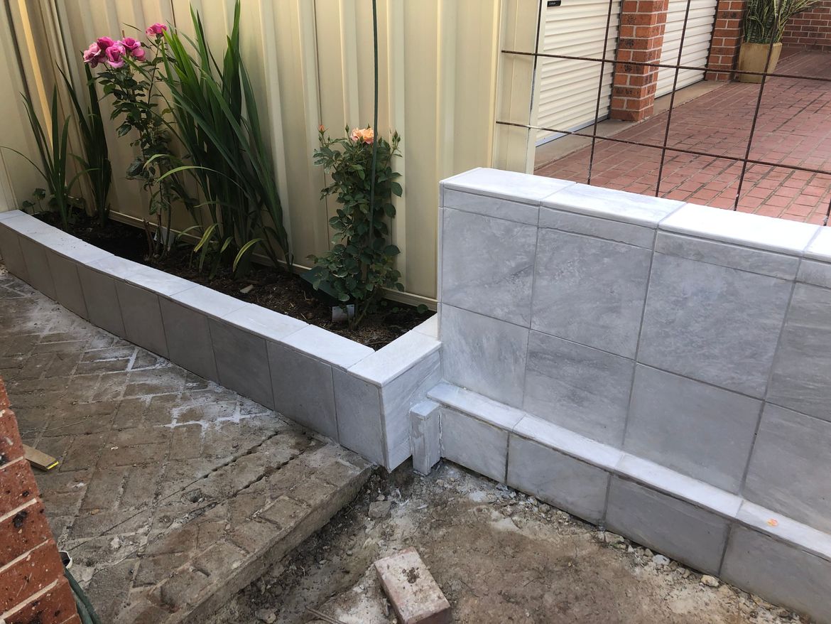

I have gone crazy with the white marble I dont know do you think this is to much for a street front?

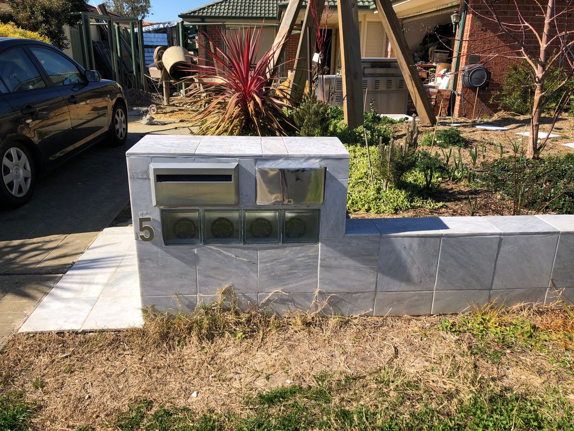

The letter box is in progress and the next level will have glass bricks (with a solar light inside) in it the next level up will have Bunnings built in letter box A4 size. The next level up might also be glass bricks with lights inside I had power run too the letter
box too just in case I wanted to use 240v lights . The final level will be sloped roof matching my house roof pitch.
I made the cement footing 400x 400mm square re-enforced concrete ( you see so many brick fences collapse not mine)

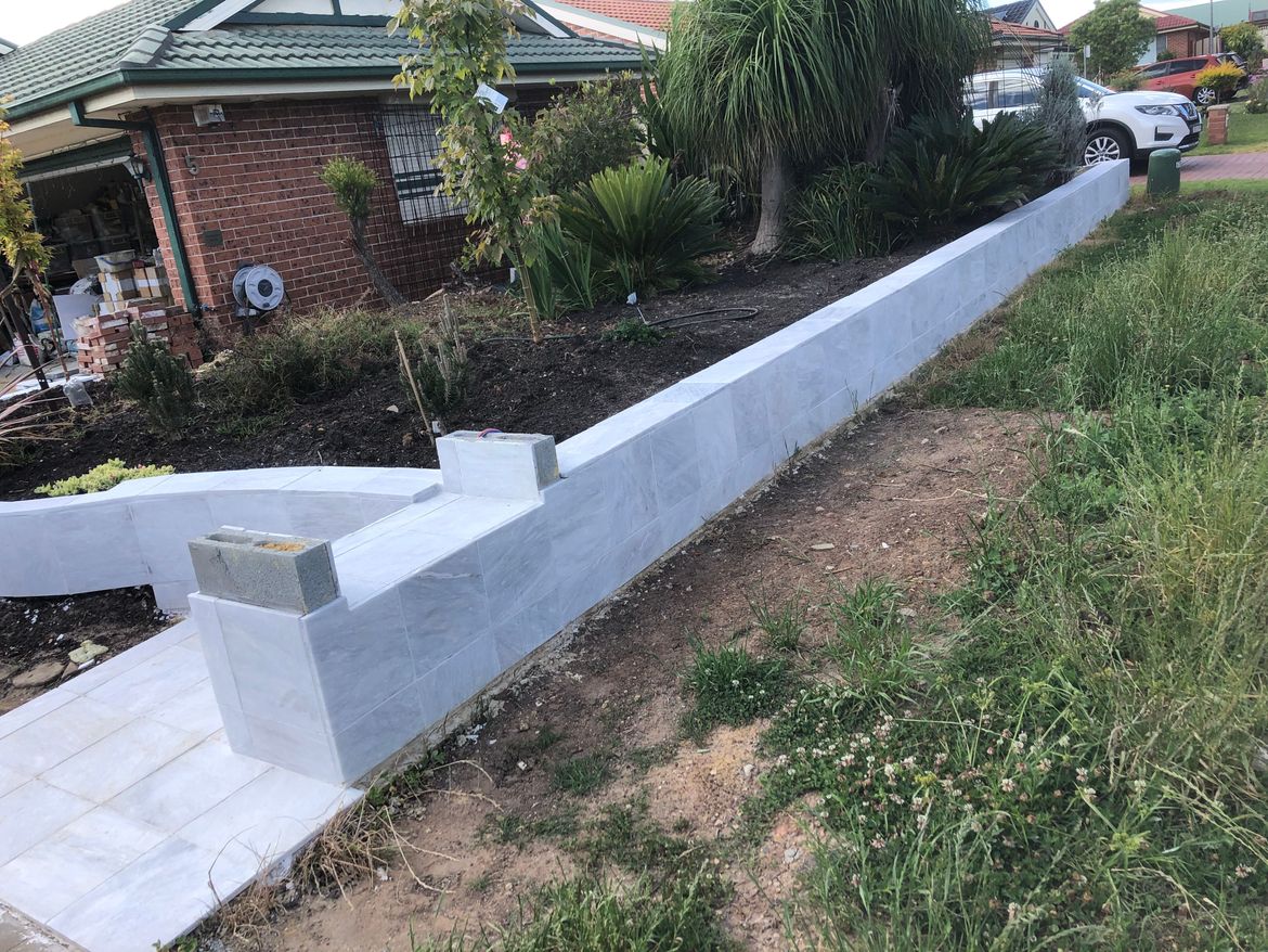

Straight wall made from cheap besser blocks 190 x 390mm half filled with cement and rubble afterwards a good way to get rid of broken bricks and building rubble.

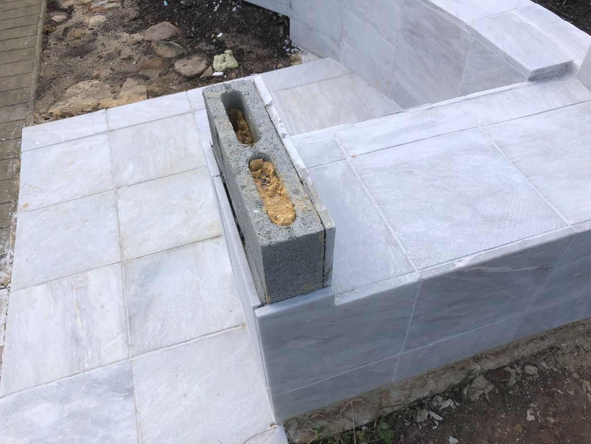

I made the curved wall out besser 1/2 thin 90 x 390 I cut some bricks in to 3 pieces for the curve sections and the outer tiles segmented to match the besser flats and approximate a curved wall.
The close up of the letter box shows the inner besser core with some marble cladding.

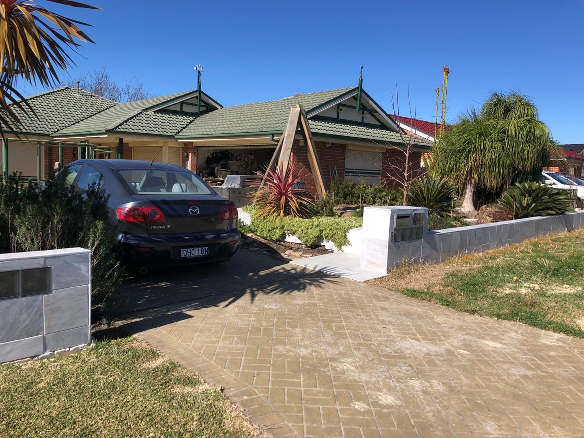

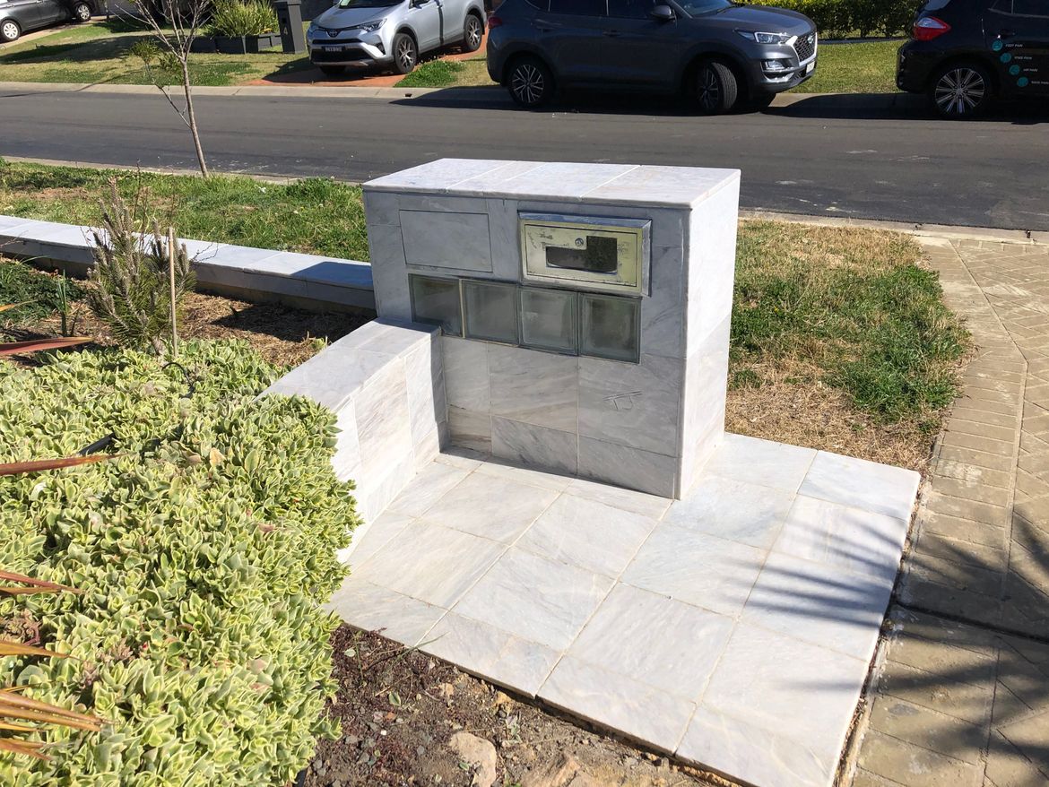

So have completed the letter box project and added a twin on the other side of the drive way as per one of my neighbors suggestions.
It has accessable working Led lights it is a block shape but I thinks works in well with the wall the curvey walls inside the property.
I even had people from tiles shops drop by to see the use of marble tiles which was surpising they should be interested.
