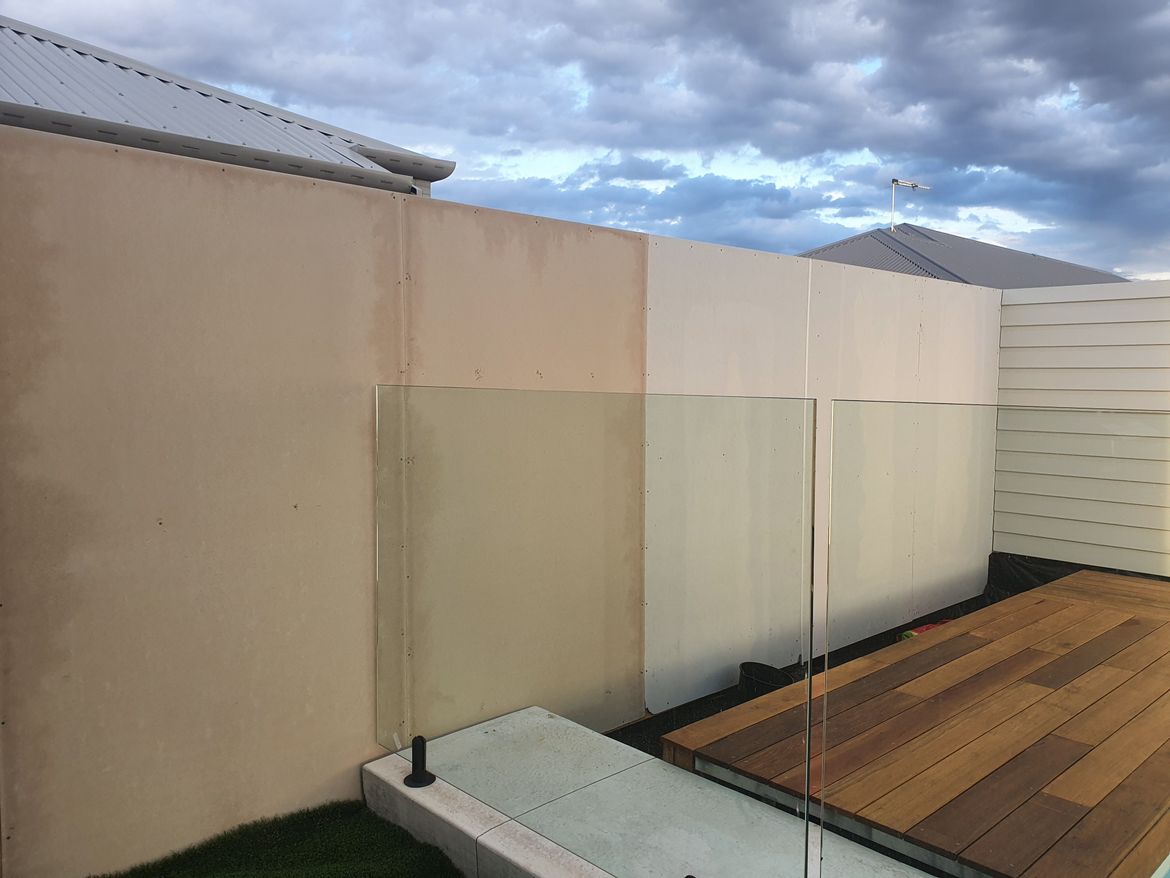

You can keep it simple like @Jason suggested with premade screens, or go the "next step up" using fibre cement boards which you can then paint. The FC boards certainly modernise the look/feel. Unfinished fence I'm doing at my place now below for context. The rear fence has James Hardie Newport cladding and the side is just flat boards. The rear is painted with a normal paint and the side will be painted with Dulux textured paint to give it a rendered effect.
However, don't underestimate the difference simply painting the fence will make. I'm a big fan of Dulux Domino as it's a bold colour choice and works really well against natural tones of timber and grass.

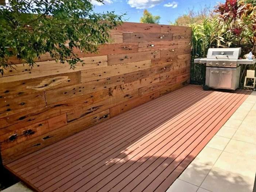

I tink I'v found a pic similar to what I had in my head for my "feature screen idea" - something like the below but in a L shape in the corner of the deck where the BBQ sits not. Then have a nice day bed, coffee table and a couple of large pot plants. Kinda make it into a little sanctuary of it's own in the corner.
Any thoughts?

Would it be possible to build a timber frame from treated pine 70x35 and attach this directly to the existing fence (screwing into the posts and rails) and then adding my reclaimed timber to this frame? Or is that likely to be too much weight on the existing fence? The fence is structurally very sound if that makes any difference.

Can the deck itself bear the weight instead? Fixing to the fence will be fine, but I would consider not fixing it onto the fence. Depending on how thick the reclaimed timber is, the additional weight on your side of the fence might cause it to become unstable.
Personally, I would build the frame sitting on plastic packers on the deck, the frame would then be fixed to the fence to secure it in place.

Thanks for the reply.
Ideally didn't want it sitting directly on the deck as I would still like space to plant some low plants in front of it between the deck and the fence.
But on the other hand I don't want the fence to eventually pull down.
I can rip the timber down to whatever thickness I like but I'm thinking around 20mm thick.
