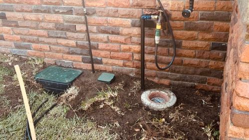

1. I started by digging the two locations where the valve boxes would be located and the channel which joins them.
2. I dug to a depths so the boxes would sit flush with the grass, taking into consideration that the boxes would sit on the thermal mat and drainage gravel.
The below picture is prior to any digging

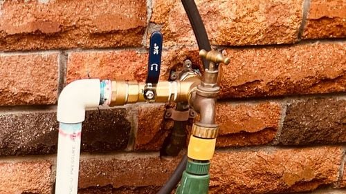

Next steps was to add secondary shut off valve to the existing garden tap.
1. The mains water was shut off and the existing garden tap was removed.
2. A 20mm brass tee was added to the garden water outlet and the existing garden tap was screwed back on using new plumbers tap on all threads.
3. A 20mm brass nipple and ball valve and was added to the brass tee.
4. A 20/25mm brass adapter was added to the end of the brass ball valve.
5. A PVC threaded male pressure fitting was added to the end of the brass adapter.
6. 25mm PVC pressure pipe was attached to the PVC threaded fitting using PVC primer and glue.
The below picture is the garden tap fitting.

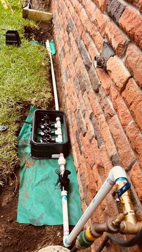

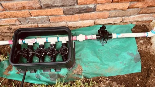

1. Next steps included priming and glueing the 8x PVC Tee fittings together using 60mm of 25mm pressure pipe to create 2x 4- outlet manifold for the solenoid valves.
2. Attach the 25mm Master solenoid to the garden tap using PVC threaded fitting.
3. Attach the Master Solenoid to the 25mm PVC Barrell union and then connect to the first 4-outlet PVC manifold.
4. Connect the 1700mm length of PVC pressure pipe to the PVC Barrel Union joining the second 4-outlet manifold.
The below picture shows the first 4-outlet PVC manifold attached to the Master Solenoid by the Barrell Union.

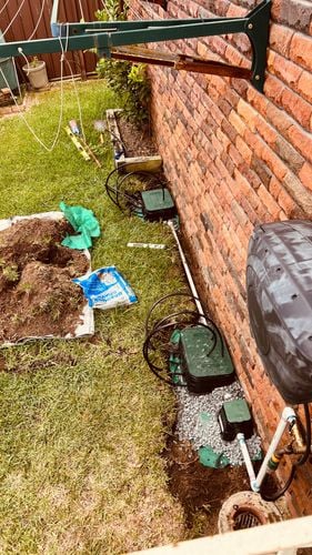

The below picture shows both Manifolds connected by the 1700mm length of PVC pipe.

1. Connect the 8x 25mm BSP to 13mm barbed connectors to the solenoids.
2. Cut holes into the large rectangle valve boxes.
3. Place the green thermal cloth under the manilfolds. The cloth is not necessary but I wanted the solenoid values to sit on a relatively clean surface and not the dirt.
4. place the rectangle Valve boxes over the two 4-outlet Solenoid values and the small square outlet over the Master solenoid.
5. Placed drainage gravel around the value boxes and pushes it under the edges to create a level top on the box. I used a spirit level to ensure the boxes had a slight slope away from the house so water would not pool on top.
6. I connected 8x short lengths of 13mm poly pipe to each solenoid value using the steel clamps. I did this so I could test the system for leaks and fill in the surrounds of Value boxes with soil and gravel.
The below picture shows the completed value boxes.

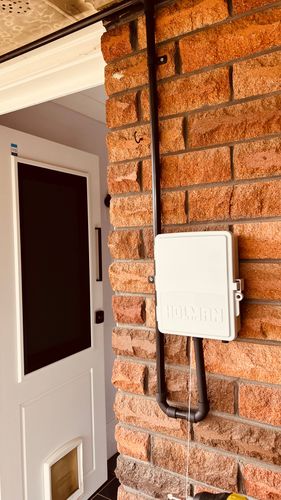

2. I wanted the controller located near my back door and near the power outlet. I wanted all wires to run neatly from the controller to the solenoid values via 20mm conduit. I sprayed all conduit and the conduit saddles with black spray paint as I didn’t like the grey colour.

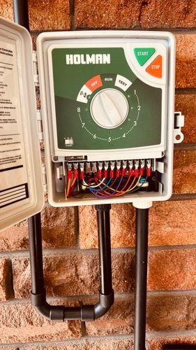

4. I attached each of the wires to the controller using small red fork connectors. The smallest fork connectors at Bunnings were too big so I had to purchase these from Jaycar. This was the only purchase outside of Bunnings for the whole project.
The below picture shows the red fork wire connections at the controller.
The below picture shows the controller and the black conduit next to my back door.
