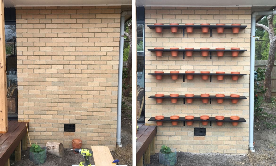

This wall is at the rear of our house, it’s part of an extension built sometime during the 80s. Since we recently built a new deck we’re spending more time outside and this plain wall has become a bit of an eyesore. It needed something.

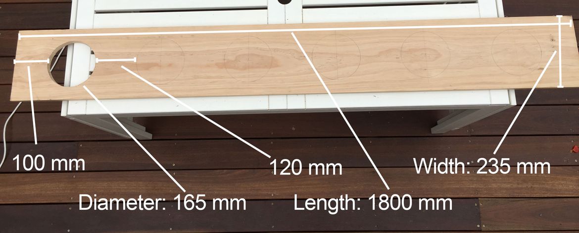

‘Measure twice, cut once’ they say. I tried that but I still messed it up. Turns out the pot that I was basing my measurements on was a slightly different diameter to the bulk lot of pots (30 in all) that I bought. So, the 30 holes I cut with the jigsaw? Wrong. All wrong. I ended up having to make them all a bit bigger to accommodate the slightly larger pots. Lesson learnt.
So I started re-cutting the holes. It was at this point that I snapped my one and only jigsaw blade while re-cutting the first hole. No back up blade? Yep, another rookie mistake. I’m now an expert with a jigsaw and I have a big packet of blades so I’ll never run out mid-way through a job again.
You can check out the measurements I used (above), hopefully it saves you some time.

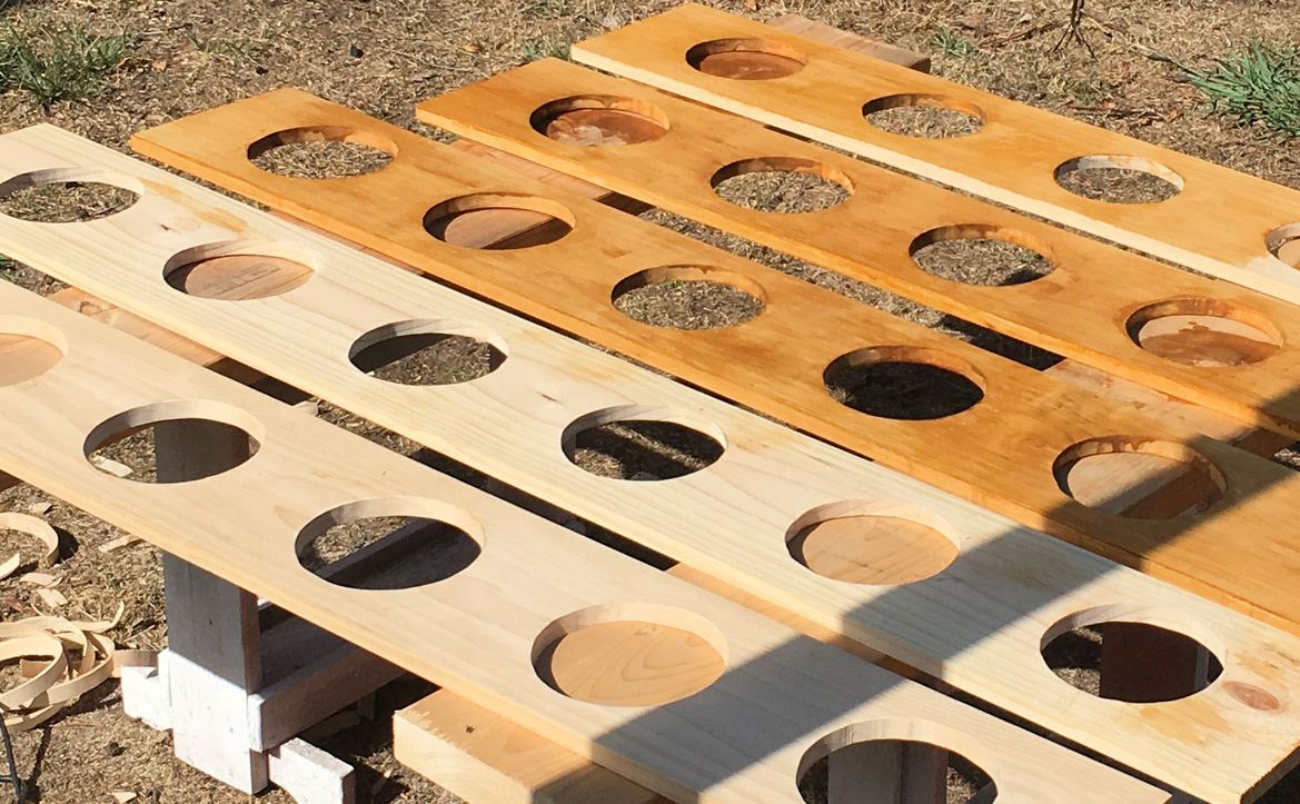

Recently I oiled our deck and it turned out pretty good (just don’t mention the drips down the side). So I figured I’d oil the shelves – what could go wrong? Plenty.
First, I bought a cheap brush (mistake No.1), then I rushed the job (mistake No.2) and ended up with drips and some areas darker than others. It looked bad. I knew it looked bad because when I asked my wife what she thought she just kind of nodded, smiled and walked off. Never a good sign.

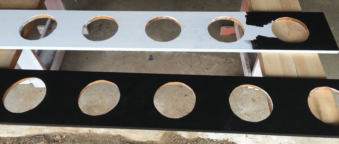

So to cover my gaffe I undercoated with an oil-based undercoat then carefully applied two coats of satin black paint with a roller. An expensive roller.
The finish was much better, check it out in the picture below.

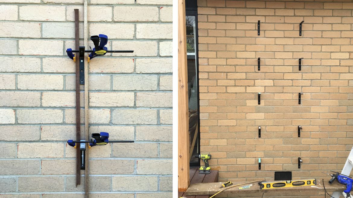

Next step was to screw the brackets to the brick wall. I used a 6mm masonry bit, two to be exact – half way through drilling holes I managed to snap the first one. It’s still embedded about an inch in the wall. I also used some 5mm plastic spaghetti and some 75mm screws.
The trickiest part here was getting the brackets lined up in a straight line. To do this I clamped a couple of stakes either side of the first L bracket to ensure the one above it was held securely in place while I drilled the holes (see below).

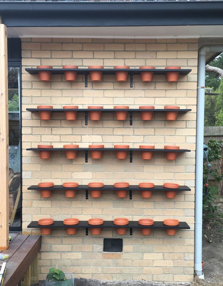

Now for the fun part. I attached the shelves with some 18mm screws, added a packer between the bracket and the shelf where necessary to get them perfectly horizontal, and dropped in the pots.
Done.
I still haven’t quite decided what to plant in the pots – any suggestions?
