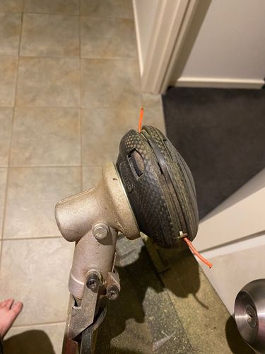

The manual does not seem to show the model I have - a bump head - and I am having difficulty putting in new line. Any advice. Should I just get the metal head - seems a lot easier
Hi @briano74,
Could you possibly share a photo of your trimmer so members can see what you are working with? It might help identify your model and provide more specific and helpful advice.
I will also ask @MitchellMc to assist when he gets back on the site tomorrow.

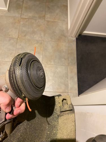

It does not appear like the bump head in the manual. I have removed the metal part and fed it around inside but it does not appear to feed well at all.
There is no equivalent lower and upper spool. Have taken it apart and does not appear like the head in the manual. Am familiar with that type from a previous Ryobi bump head with that configuration. Is it possible to bring it into a store for some assistance??
Many thanks for the additional details and pictures. This is an Oregon Gator SpeedLoad Trimmer Head which uses a cartridge system. Oregon Gator SpeedLoad Trimmer Line .095" would be the correct replacement product. You'll place the cartridge onto the internal cast metal plate and feed the lines out the guides on the side. Once you have fixed the cartridge in position, you can then clip the head back together and begin trimming.
