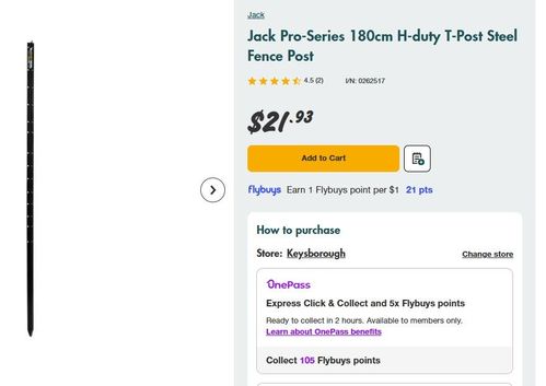

Hi @CaseyE,
Rather than timber posts I suggest from the Jack product range:
Use the Jack H-duty T-Post Steel Fence Post and browse for Mouse Mesh.
