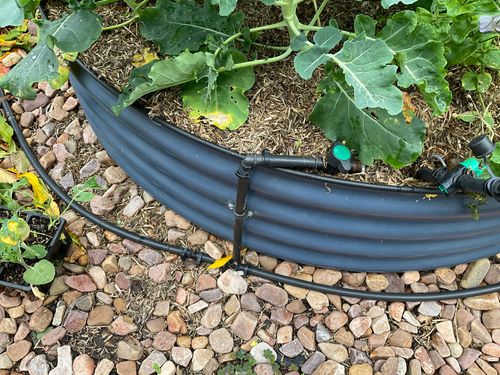

I have galvanised raised bed with irrigation installed. A simple riser with a saddle clip does the job. Photos attached for your reference. This have been installed 4 years now and works a treat. We can used the programmed sprinkler system or click on hose, by use the turn valve, thanks to my Dad and ingenuity 😀On off valve to a hose connector
Sadle clip and main line irrigation

Thank you so much for posting your irrigation setup. I'm sure @SeanDunne will appreciate the photos you've shared. I see you and your dad used Zenith 8G x 12mm Galvanised Hex Head Metal Screws. That's an excellent way to hold the saddle clip in place. Have you had to change any of the irrigation pipes during the four years of operation? Any other tips or information you can share about your irrigation system would be much appreciated.
