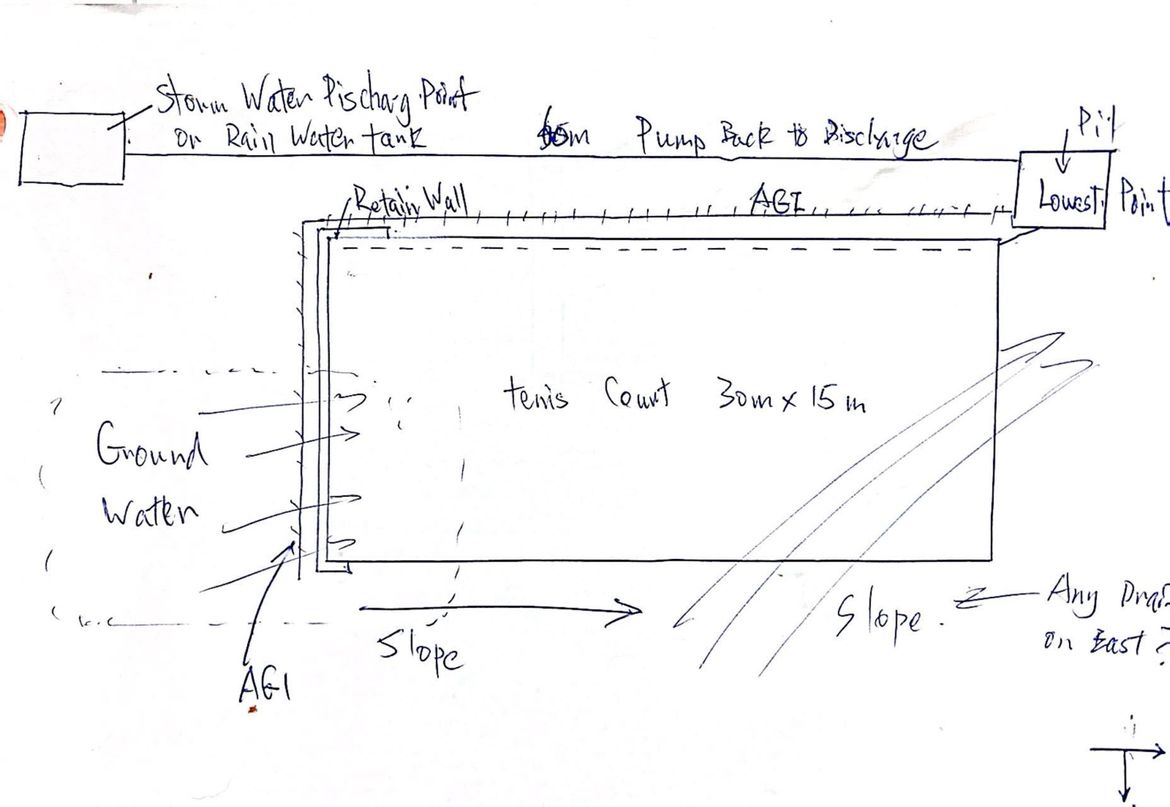

Hi, we're building a tennis court in our backyard but noticed some areas are still wet even on dry days. We're planning to install an AGI or French drain to manage the groundwater. The stormwater connection is at the front of the house, so groundwater collected at the low point will need to be pumped back to the front. We're also building a retaining wall—how far should the AGI drain be from the wall, and how deep beneath it should it go, considering we're digging a 300mm trench? Should the AGI surround the whole court, or is it enough to cover just the lower (west) side? The court will have a 1% slope towards the lowest point—would a pit work, or should we consider an underground water tank with a floating pump that activates as the water rises? Can I handle the AGI and pit installation myself and just get a plumber for the connection? Can we also install a roof barrier to stop the tree root at the back? Any advice would be appreciated. Thanks!
The wet area on the dry indicated ground water
AGI Drain to clear ground water
