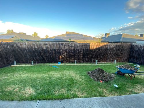

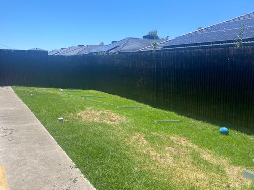

Hello there. I am planning retaining wall in my backyard, having slope of approx 600mm from the lowest point to the desired height of Alfresco Floor.
The retaining wall will be U shaped 13.2m x 4.8m x4.8
=> Question is H4 sleepers along with timber stumps are suitable for this project
OR
I should use the concrete sleepers here with galvanised posts?
(The ground will be levelled afterwards assuming the wall should be sturdy to withhold 8-10 cubic meter of soil)
I want longevity but when it comes to using the concrete sleepers It wont be easy to tapper the sleepers ☹️
Looking forward for the valuable feedback

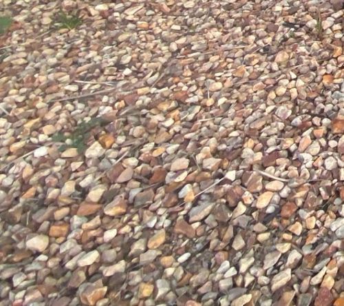

Another Question is can I lay the stones (pic attached) at the base of posts ?
Regards
Mo
Hi @Mo2,
You can add gravel under and at the base of the post, which will assist with drainage.
There will be directions on the concrete as to how it should be used. If you are using Australian Builders 20kg Quick Set Concrete, you would fill the hole partially full with water and then pour the dry mix on top of it. There's a video on the product page which shows how to do this.
Provided you follow the directions on the packaging, dry pouring will be adequate strength-wise.

Gravel as @MitchellMc has said will enable drainage so why not.
