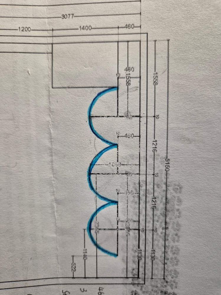

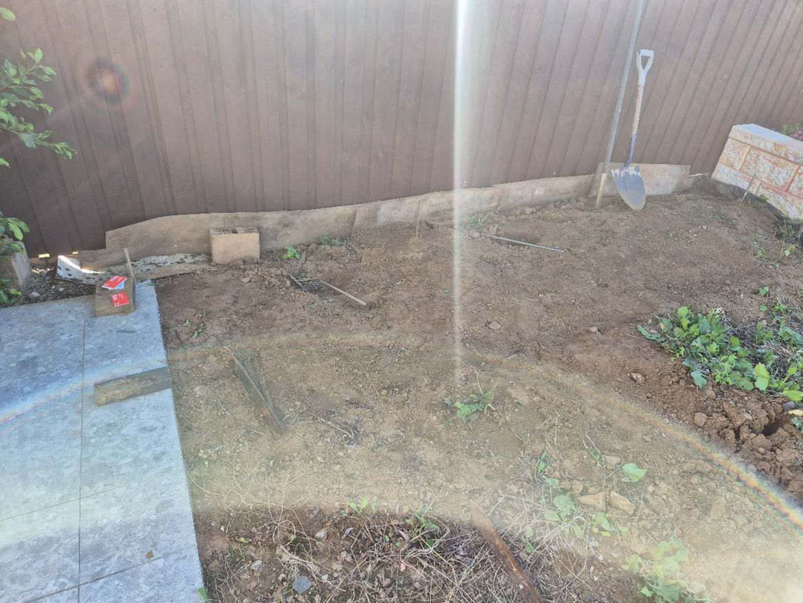

Good morning all,
I am gonna build a garden (roughly 5m long) along timber fence with Brighton Masonry Eziwall Lite Block. It's a 3-half circular wall design with 1 course. Will bury half a block in the ground. Please refer to images attached, the garden is highlighted in blue on the plan.
So, here is my question - what should I use to build the footing/foundation?
Have done some research online. Some use compacted road base and damp sand and cement mix over it while others use mortor, tooth paste consistency.
Which method will give me a stronger and more robust foundation? I dont expect lots of traffic on the garden. However, walking/stepping occasionally on the wall block is inevitable. Also thinking to plant some Lilly Pilly Resilience or Ficus Hillii Flash inside the garden, both of which will grow an massive root system.

Thank you @JacobZ so much for the tips and advice.
How thick of the concrete strip footing shoud be?
