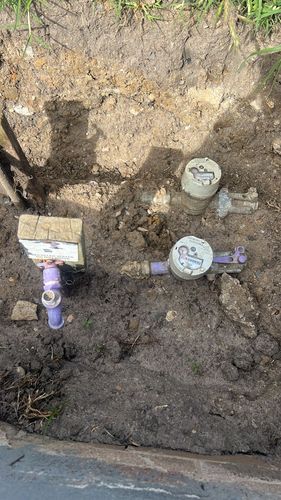

Hi
I am in similar situation but mine is in ground. Is merbau suitable?
picture attached.
thanks
Hello @istcian
Welcome to the Bunnings Workshop community. It's sensational to have you join us.
For your cover, I suggest using sleepers for in ground use. Once you are above ground you can then use the Merbau panels. Sleepers are H4 chemically treated for in ground use or direct soil contact. But as soon as you are above ground you can then begin using the Merbau timber cover panels. Please note that the posts you are using must be H4 treated as well.
