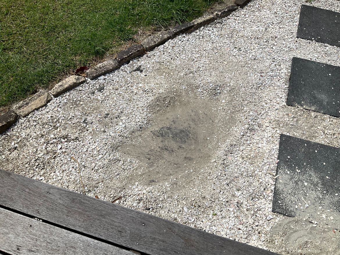

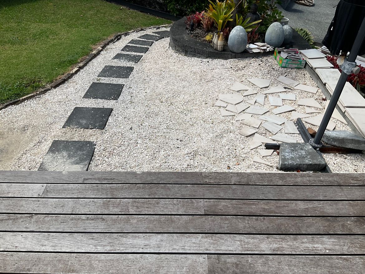

Hi thanks for your reply. I was wanting to use the shells not as a base but in between the tiles. Underneath the shells at the moment is black lining . The path is quite uneven as it is on a dirt base . I am trying to establish this the easiest way I can .
I see your path slopes, so there's always going to be some level of unevenness. You could follow How To Prepare And Lay a Base For Pavers, but unless you plan to level the whole area, this might be a bit tricky. Were you planning on adhering the tiles to the pavers or making the whole pathway out of the broken tiles? Tiles need a solid base, so you'd either need to use the pavers or pour a concrete path first. Once again, though, you'll need to work with the slope.
