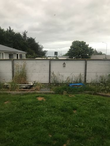

I think I’m going to end up spending hours on here lol Hopefully it will keep me from buying so many bulbs online which is what my question is really about. I have corregated iron fencing and wanted an idea for how to build shelves or use pellets etc for hundreds of small pots from 7cm to about 12cm for splitting up all my bulbs that will be put at the gate for sale. I have wood, iron and pellets and other bits and peices in my handy piles and really prefer to use things I have as most of my money goes on my animals which I’m mad about besides my bulbs. I have quite a few health problems and in a lot of pain 24/7 with spinal stenosis, fibromyalgia and brittle bones but I don’t like sitting around and brought a bigger house and 3 acres so my animals would have an extra 2 acres. Unfortunately since then a lot have died and that’s when I got into bulbs. I don’t have enough long lengths of wood to reach between the posts so wondering if cutting up pellets and screwing them onto the posts would work. I thought maybe 3 on each post with a board across the front so they don’t fall off and maybe painted white with a black name tag and paint pens once I work out what is what after a bad wind blew about 300 tags out of different varieties lol will add a photo of the fence and a a few of my collection. I thought it might keep them dry in the dormant season rather than me having to try and find places and more hundreds and hundreds of pots. Any ideas please and thanks 🙏 please excuse the gard en at the moment. Have about 12 times that much at least so trying to get all the bulbs that can stay out into gardens to cut down on the work with the pots but still keep the varieties separated.

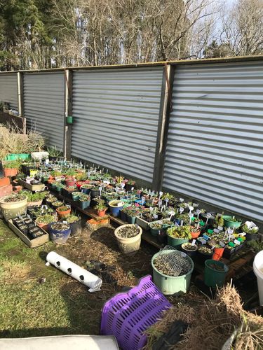

Hi, awesome ideas. I have some blocks and a huge pile of normal bricks and a big pile of pavers lol my “come in handy piles” I call them and have had a lot of flack from Freinds calling it rubbish over the years till they needed something and were broke then changed their minds lol the big blocks I can move a couple at a time on the sack barrow but I tried them and the bulbs didn’t get enough sun in the only spots I could put them and I need to keep the longer bits of timber to hopefully get some shelters built for the ponies over summer. I have a couple of handy boarders but don’t like asking for help so try to save them for the big jobs. I’ve been collecting cardboard boxes and we have a big pile of wood chips. Also have rolls of black plastic and weed mat but weedmat just annoys me and I’ve just finished pulling up the stuff that looked 10 years old lol I’m thinking pellets might be the easiest thing. I have a few places round town I can get them and have a few here. I didn’t know about the carpet squares so might have to check that out for the dogs kennels and the emus bedroom cause it’s a concrete floor and she is getting older so even though she has carpets and those kids foam mats another couple of layers underneath her long skinny legs so thanks heaps for that idea.

This was my best and easiest idea I think. Believe me you don’t want of all my piles spread round the paddock at the moment but will definitely put up before and after photos. It does take me a while to get things done though and I’m fighting grass grub and god knows what else at the moment. Half the house was built too many years ago and you can’t get under it to insulate and now I’ve started getting things pulled out you can see the rain has all been going straight under the house and started rotting floor boards in my bedroom and bugs have invaded so I retreated to the lounge till the sheets of new flooring arrive and have a lot of gaps to fill so I never want them all deciding to camp inside after the spray man has done his thing again.
