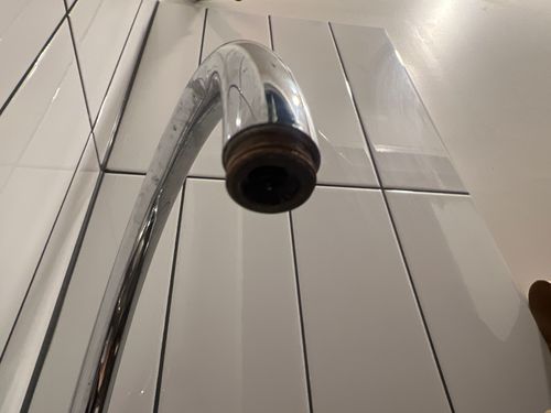

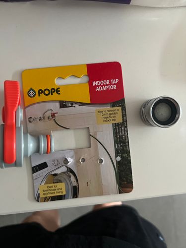

Hi there! i have bought a garden hose adaptor to apply to my laundry tap inside my house but it doesn’t seem to fit, i want to see if there is any other adaptor that will be suitable for my indoor taps.

What I have noticed with the goose neck sink mixers is that the aerator filter that is attached to it is not a standard size. If you still have the aerator filter in your possession, I suggest comparing it back-to-back with the adapter head of the Pope tap adapter. I suspect that you'll notice a significant size difference between the two. The Pope tap adapter will only work with a standard 13mm threaded spout.
The Pope tap adapter will work with both male and female fittings as you'll see from the image below. The only option to make the fitting work is to change your kitchen tap into a standard kitchen mixer such as the Caroma Elegance Stylus Sink Mixer. It comes with a standard aerator that you can remove and replace with the Pope tap adapter. I'm sorry but there are no tap adapters that will work with the goose neck sink mixer.
One other option is to have a dishwasher tap installed on the cold outlet under your sink. But you'll need to engage the services of a plumber in order to install this properly.
