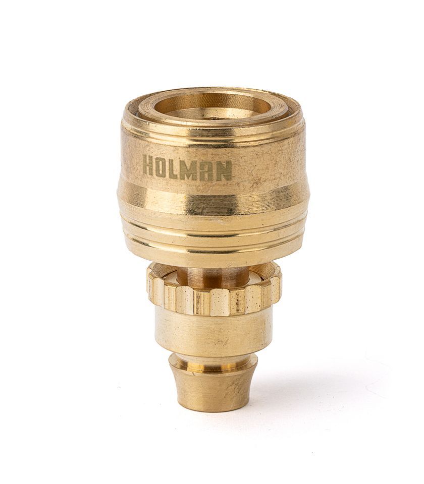

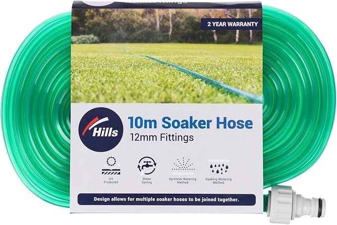

Elbow connector male/female 12mm to connect garden hose with soaker hose
I would like to find an elbow connector, preferably metal, that can connect this 12mm male soaker hose to a 12mm female garden hose.
oSoaker HoseSoaker HoseGarden Hose ConnectionGarden Hose Connection

Hi @Michael1111,
Unfortunately, I am not aware of an elbow connector that could be used to directly connect your garden hose to a soaker hose.
You could connect a Holman 12mm Brass Sprinkler Adapter to the garden hose, then connect a Brasshards 20mm Brass Male / Female Threaded Elbow LF to the sprinkler adaptor. You could then attach a Holman 12 x 20/25mm Brass BSP Tap Adaptor to the male thread of the elbow and use a Holman 12mm Double Ended Hose Connector to connect the soaker hose to the other end.
Physically, it can be done, but it would require a few adaptors that would make the connection rather bulky.
Let me know what you think.
