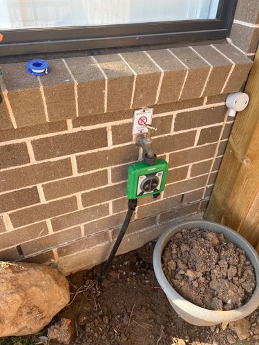

Thanks. I went the same way, went little further by installing a wifi tap adapter with two outlets.
