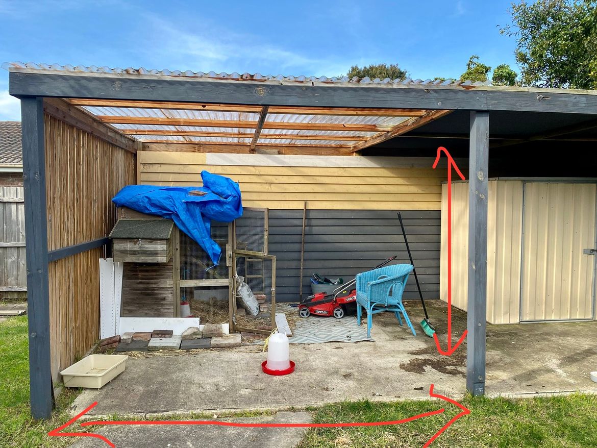

I have just adopted three rescue hens who are free-range during the day. I would like to have a larger run/enclosure for when no one is home that is also predator-proof if we are out later in the evening. Our coop is a secondhand one - we haven't decided on a 'forever coop' yet but will get an automatic door when we do.
In one of the many chicken groups I've joined online, it's been suggested that I utilise this undercover space. Some have suggested using temporary fence panels or mesh wire - which sound great but I still don't know how to make it work. I am not a 'handy' person. I hardly own any tools and even if I did, have no idea how to use them - haha. I don't have any 'handy' people in my life and am trying to avoid paying someone which is why I thought I'd come here for advice.
Area measurements: 3.2L x 3.4W x 2.4H
Any ideas on how I can make this area as predator/pest-proof as possible with my lack of DIY skills?

I think your cat enclosure would serve as a reasonable example of how you could complete this work. As a temporary enclosure, you could use bird netting that is attached to the timberwork with Pryda Foil Fix and into the grass with tent pegs. For the concreted area, you'd need to lay some timber for the netting to attach to. Creating a door for this enclosure would likely be the most time-consuming part. To construct a basic door, you'll need to first build a frame and then the door. You'd require at least a handsaw and a drill driver for this.
As a simpler option, you might like to take a look at the Selecta Multi-Purpose Heavy Duty 80cm Animal Enclosure or RapidMesh 2290 x 2290 x 1800mm Chain Link Animal Enclosure for a more permanent solution.
Let me mention one of our resident chook experts, @mich1972, to see if she has any advice.

Now if we were in rural / semi rural area I would definitely enclose the whole area you want. Including burying the fence partially into the ground if it is over the soil as foxes can dig underneath the fence. Fencing that sits on solid ground like concrete or pavers, make sure you put a solid barrier on the base of the fence as they will still get underneath. Make sure the mesh holes a small enough that predators can’t squeeze through.
I won’t bang on too much and get you overwhelmed but definitely follow Mitch’s advice. Good luck and look forward to seeing what you do and enjoy your beautiful Chooks. Regards Michelle 🐓

Thanks so much @MitchellMc - great suggestions! Re: the door, we have an old security door lying around so I might look at repurposing that. If the door stuff is a bit complex for me, I might have to get a professional in but everything else seems doable.

I’m in Victoria, just outside of Melbourne. I’d say we are more semi rural than in the suburbs. Definitely have lots of foxes around here unfortunately so that is a big priority. I will be putting a solid barrier on the bottom and will likely enclose the whole area. Especially as we have the roof already there.
