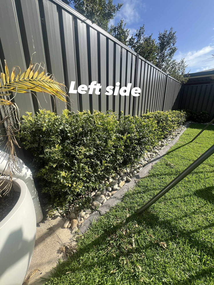

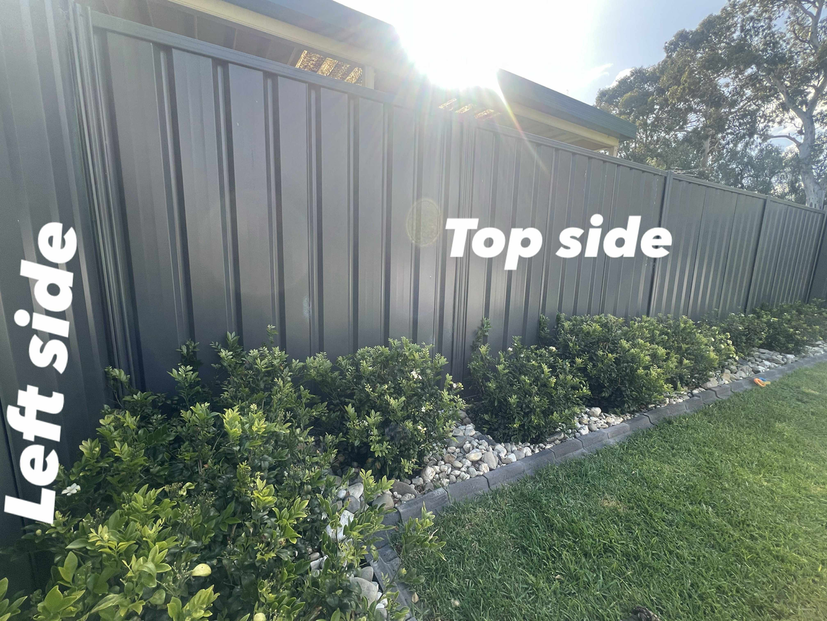

Hi, I currently have 7m (left side) and 9m (top side) of Murraya Paniculata hedging plants. As the plants have started to grow bigger, watering them has become more difficult as I have to get under the leaves for each plant, and very time consuming.
I am looking to set up some kind of irrigation system. I do not really know where to start, or what product I should be looking at.
I would love to hear if anyone has any thoughts on how I should approach this, I would like to give a deep water to the plants 2-3 times a week, which using a hose on each plant isn't really feasible time wise. Should I look at a soaker/drip feed etc.
I have a garden tap attached to the side of the house, between the garden hose and the lawn is cement, so I guess i'll have to run some kind of piping over the cement. In the garden bed I have rocks covering the dirt, and garden edge pavers as you can see in the pictures.
If I ran some kind of irrigation system, could I temporarily move the rocks, then bury the irrigation under the rocks, then put the rocks back on top of it, so it can't be seen. And could I run the irrigation next to the pavers (or along the fence)? or does it need to be more centered near the center of the plants so it evenly waters it?

A simple way to set this up is to run a single weeper hose, such as the Nylex 12mm x 25m Weeper Hose With 2m Garden Hose, around the garden bed. For best results, position the hose as close to the base of the plants as possible so the water goes directly into the root zone. Running it along the fence line won’t be as effective, since the water needs to soak in around the root ball. Pulling back the gravel and tucking the hose underneath is a good idea, as it will hide the line while still allowing the water to get through.

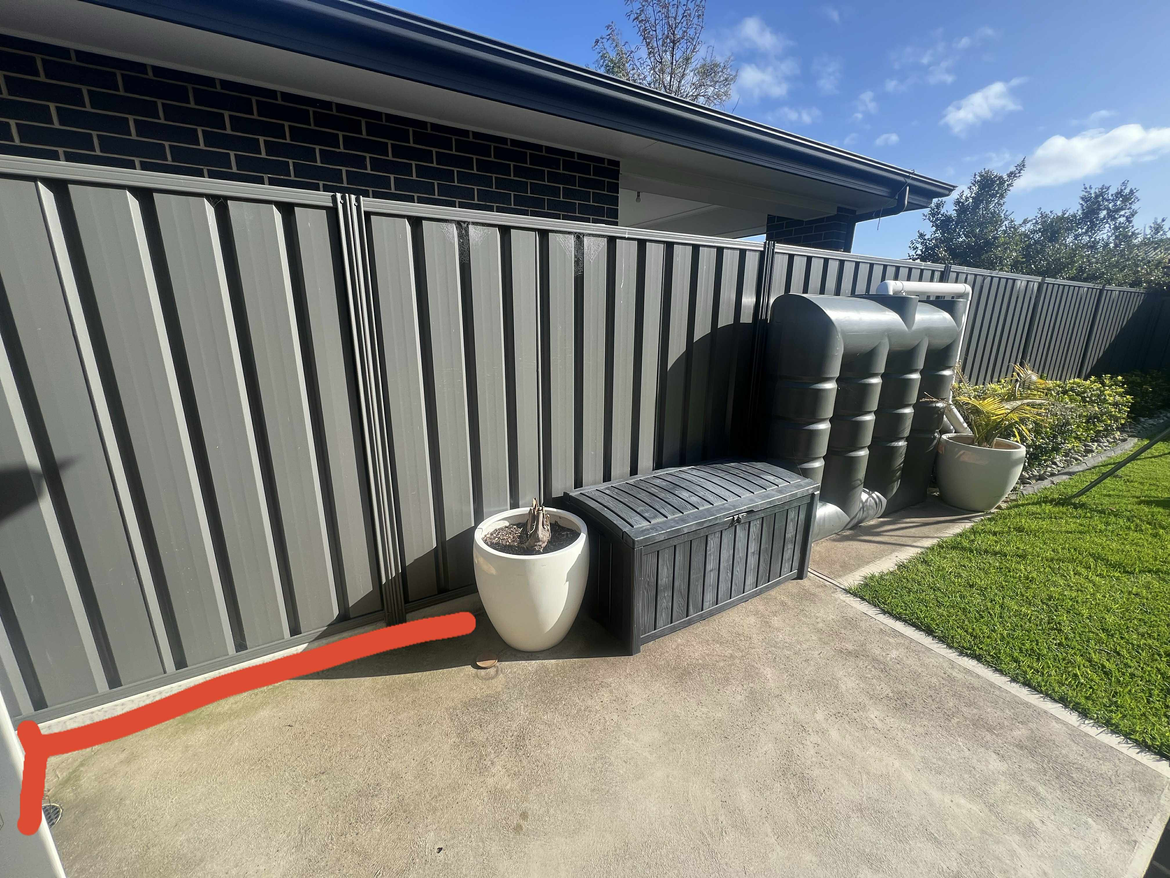

2. IfI can run the cable behind the rainwater tank, and along the fence, then a small part of the end cable horizontally to the tap, is there a smaller cable protector, something that would allow me to tuck the cable in between the floor and the base of the fence. Also something that doesn't stand out visually so much.
Re: Deep watering irrigation
Yes, it's perfectly fine to run the weeper under the rocks and on top of the weed mat @Murlun. You'd probably secure the hose in the corner neatly between the fence and the concrete slab. If you can show us in a picture the area you'd like to cover, our helpful members might have some ideas.

Hi @Murlun,
You could use some trunking in a suitable size for your hose.
This would cover things up nicely while still giving you easy access to the hose if required.
