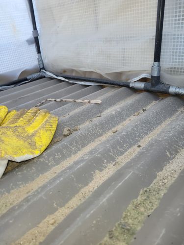

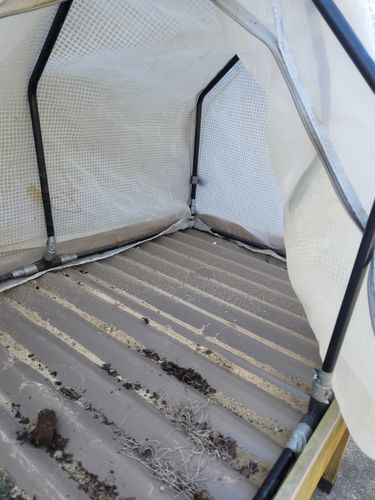

I have this planter/greenhouse box that I was given and was wanting to use it as a herb planter. The top is about 5cm depth. Is this enough space for the herbs to grow on top of? Or do I need to look at removing the metal sheet?

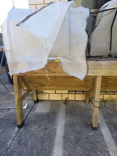

It is also a bit flimsy and some of the sheet wrapping has come undone, any recommendations on the best approach to fixing these? And any suggestions would be appreciated for any improvements needed.

Unfortunately, 5cm is quite shallow for most herbs. Most common herbs like basil, parsley, thyme, or coriander need at least 15–20cm of soil depth to establish healthy roots. If you had the herbs in pots of a suitable size on top of the metal sheeting, it would be fine, but if you wanted to fill them with soil and plant the herbs, you would need to modify it. If you'd like to do this, I'd need to see how the metal sits on the base to offer ideas on how to modify it.
The timber structure itself looks nice and sturdy; however, I am not so confident about the frame over the top. The design looks fine, but it doesn't look like it is in great condition, with duct tape being used to join the sections together. You could essentially recreate the frame using Poly Pipes and Poly Pipe Fittings, using hose clamps to make a more solid connection.
You can replace the cover with this Polytuf 2.4 x 3.0m Clear View Tarpaulin, using cable ties to connect it to the frame. You can use a Eyelet Plier Kit to put some small holes in the tarp where you need to feed the cable ties through.

To grow herbs in it I would actually grow them in conatiners that you can switch out as you use the herbs and they die back. Jack 495mm Charcoal Outdoor Garden Up Classic Pot as an example height/width. A lot of nuseries have reuse pots available as well tho I would wash and clean them in the sun to stop any cross contamination issues.
If the legs are shaky, you can attach a diagonal brace across them. Screwing into each leg as it passes the diagonal brace. I would go a brace on either side and either end.
Change over the old roofing material with new shade clothe. @JacobZ has mentioned a clearer one that may be suitable.
