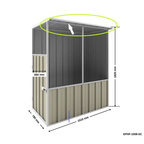

It's highly probable that there is an entryway that you have not yet seen. It's the only logical conclusion especially if the bottom section of your aviary is secure. The only section that it can be squeezing through is the least expected channel that you would ignore. It's either climbing the cage and going through a soft section in the middle or has found a way at the top. As an experiment I suggest covering the roof section of your aviary with Jack 900mm x 5m 6.5 x 6.5mm Mouse Mesh in combination with Wooden Mouse Trap - 2 Pack to see if it will deter its attack.
If you have a security camera you can also point it temporarily at the aviary to see if you can catch the vermin in the act.

Question is marked as solved but after 25 years of doing chooks I would like to add some suggestions.
Very likely they are sneaking in through the 'peaks' of the roofing so setup one camera to monitor that area.
@EricL suggests covering the roof section with wire mesh but for that to be effective you will need to remove the roof.
Wearing gloves I cut a narrow length of chicken wire, squash it and then working along shove it into the holes (the peaks).
If needed use wire or cable ties to hold it in place.
You will need to do the same for the back of the roof and right around the back and sides both top and bottom.
Do not use expanding foam, it will make a mess and they will eat through it.
