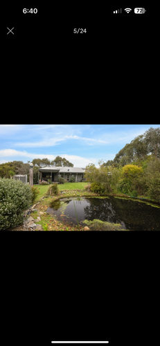

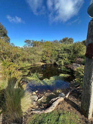

Wondering what some ideas are to make this pond safe for children. It’s quite large, don’t have the exact measurements. We have a 2 year old and another baby on the way. Is there any good ideas out there for us?

Nice rural looking pond by the way .
As @JacobZ best to get guidance from your local area as to what may suit your situation. Dont dob yourself into council yet ( do some low key enquiries ) into to your pond as this may require you to have yearly costly inspections just to see if you gate works well etc I am all for kid safety but not fees .
Some areas with large water bodies indicate you need to fence your house in full rather than you water body. So I am saying potentially as a smaller option just for your young ones make a fenced kid safe play area at your house using pool fencing and pool gate at your house back door leads into until your kids big enough to teach them to swim might be the ultimate safe measure. Plus a play area might be a clear area so any snakes around might be ease spotted if toys kept reasonably tidy so consider lining any fence with snake/ rodent 2mm mesh wire. A double safty feature.
Pool fencing is as cheap as $125 a panel 2.4 m and posts are easy to install the hardest part is hanging the pool gate . I just installed two sections of pool fence asa saftey rail on a raised 400mm garden bed for elderly fall protection. I think you could do it with a little DIY study.
Clearly too fence around a pond in dense bush is near mission impossible given kids can use nearby brush as ladders so a whole clearing around the pond would be needed.
Native and domestic animals will need that water to live so you cant fence them out of the pond directly you could be fencing out local populations of koalas or many other species.

With the pond Id actually go for a further back then closer to the water, it may use some extra pool panels but the view of your pond is worth keeping pristine. The councils website will have whatever rules that need to be followed listed. It mainly comes down to no one being able to climb it, physicallly solid. and nothing inside or outside that can be used to climb it.

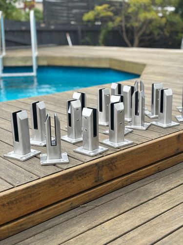

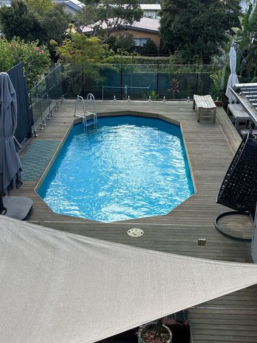

Personally I would treat this as a pool and follow the guidelines for fencing as @JacobZ as mentioned. Remember pool fencing is not just to protect your own children but those of your neighbours. The range of ProtectorA1 panels he linked is a very easy and cost effective DIY solution. However there is also an abundance of 2nd hand compliance fencing also available which would be where I would be looking at. Last summer I installed approved glass panels for a mate of mine that retailed for over $2K that he bought for $250. We bought new spigots for another $200 and reinforcing timbers for under the deck for similar.
I like this style of fencing for your application as there is not cleaning maintenance and still allows the family to enjoy semi-uninterupted view of the pond and wildlife.
