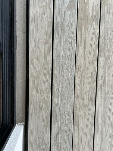

Hi team, I'm building a DIY deck for the first time and have been facing difficulties for over a month without completing it yet. I started laying the deck from the end and noticed a small gap (5cm from the wall and deck, 8.5cm from the door and deck) between the house and the deck. I can't adjust the starting deck position due to the base frame, and trimming the decking board in this narrow space is challenging. What's the best solution in this case? Appreciate your advice.

For the gap at the wall, I would increase the gap between your boards ever so slightly so the last board finishes at the wall. If the gap is 50mm and you have 25 boards, add 2mm to each gap to take up that extra room. Alternatively, you can take a board and cut it down to fill the entire gap. Say, you are running with a 5mm space between your boards, you'd cut a board down the length at 45mm from its edge to fill the space along the wall. Then, make a cut perpendicular to the board to remove the excess and continue to cut the board for the portion in front of the door at 80mm from its edge. When you're done, you'll have a board in a bit of an L-shape that's 80mm, and that then turns into a section of 45mm.
You might need to install packers right in front of the door to get the right height, but this L-shaped section will fill your gap.

Thank you for the great advice. I am using Quickfix for Ekodeck 6mm. Can I still increase it by 2-3mm to make an 8-9mm space? Will it still be strong enough? Our deck size is 6370mm x 3195mm, and I have 22 boards in the horizontal layout, including the picture frame. Thank you.

It would be fine to have 9mm gaps @minjsiow. However, I suggest you lay out the boards to see what you think about a gap of that size. You might not like the aesthetics of such a large gap.

Just one more thing: when you mentioned using packers to achieve the right height in front of the door, is there any specific brand or items that I can purchase from Bunnings? I need to raise it by around 3cm. How do I secure the board onto these tiles? Thank you!

For ease of assembly, I suggest having a look at the Macsim 45mm Assorted Window Packers - 100 Pack. It can be screwed on or glued onto the panel.
To test the fitting, I recommend using double sided tape to make sure the packers sit properly on the decking panel. Once you're sure of the fitting then you can permanently fix it in place.

Now that I have all the directions, thank you. Lastly, for the window packers, how can I attach them to the tile next to the door? Should I use glue or will double-sided tape work? And nail between the packers and the decking board?

You could try glue @minjsiow, and I'd recommend a polyurethane like Sikaflex 11FC. However, it would likely be best to drill holes in the tile with a tile drillbit and insert plastic plugs. You can then attach the packers to the tiles with screws and then screw the decking board to the packers.
