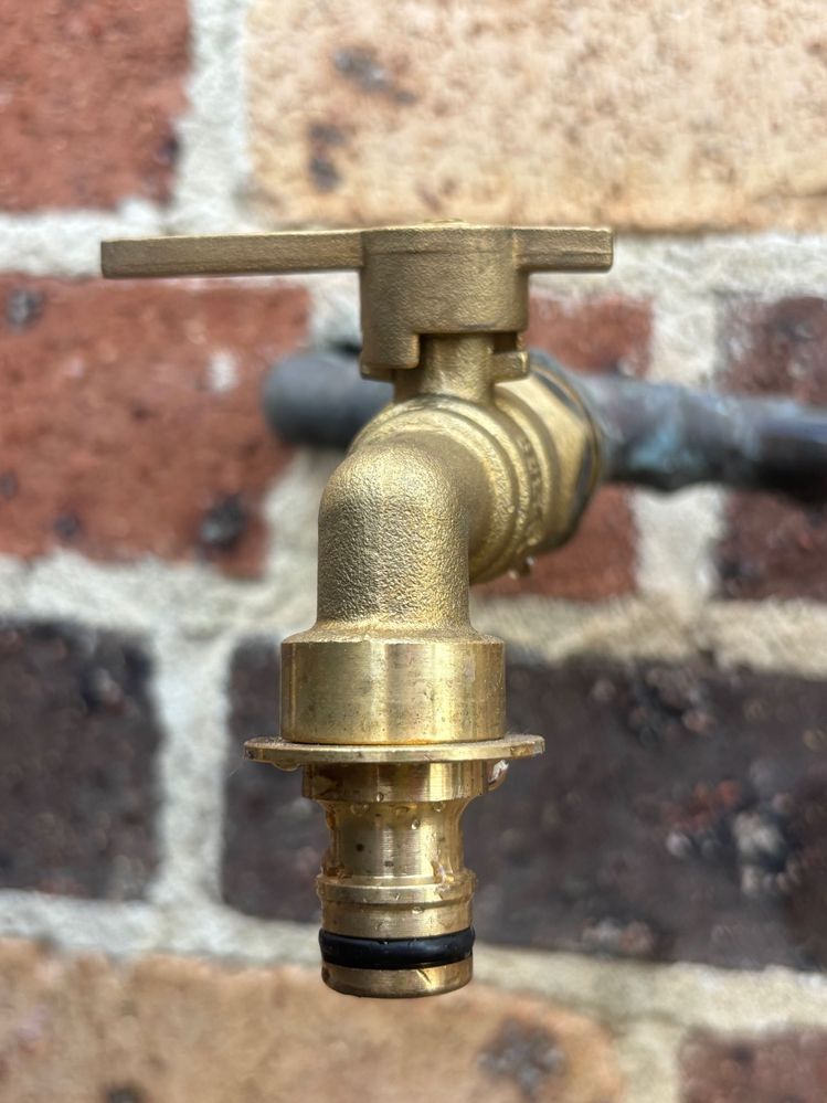

Recently I replaced a traditional garden tap to half turn one as in the link above.

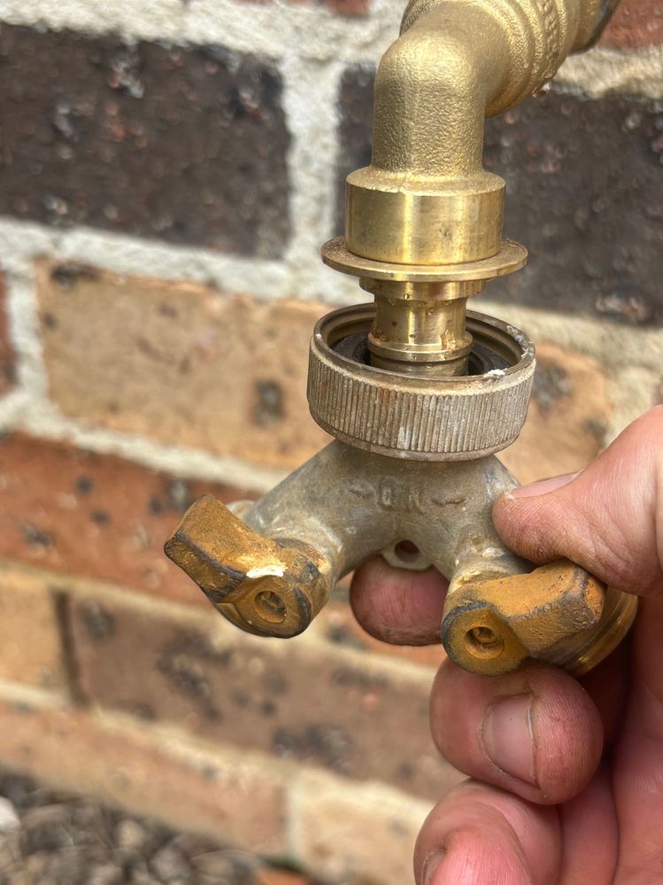

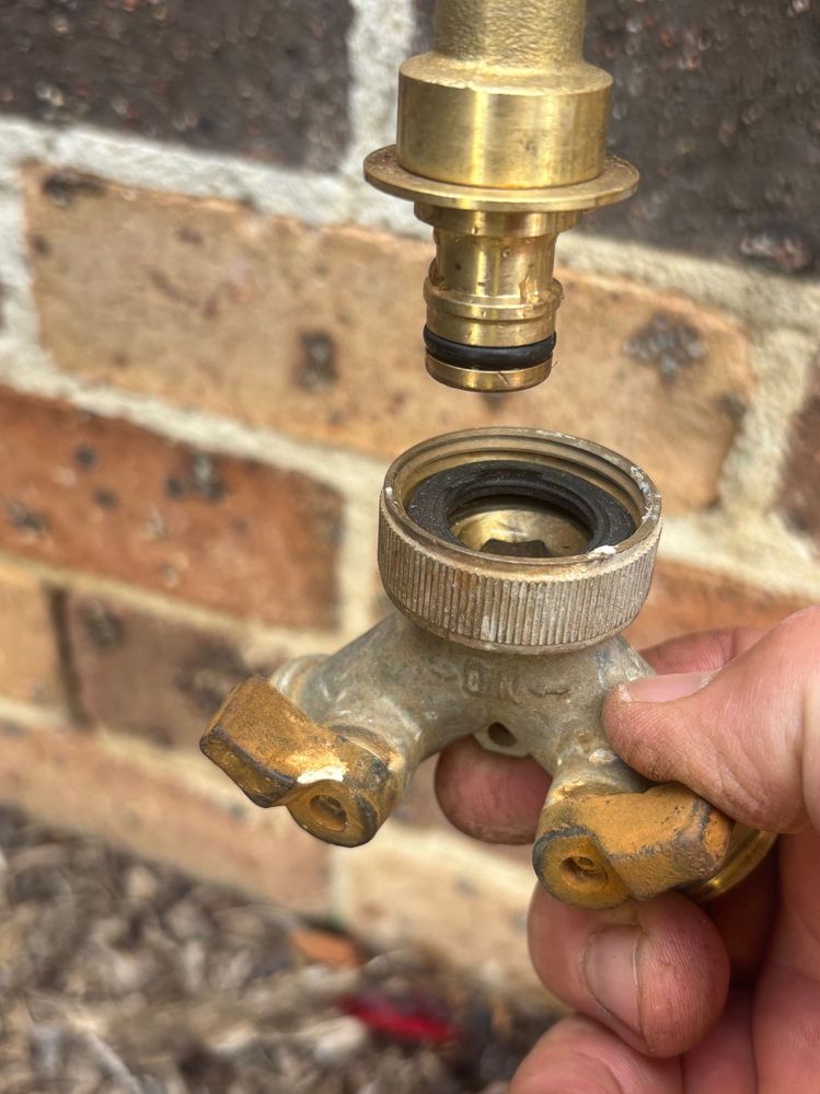

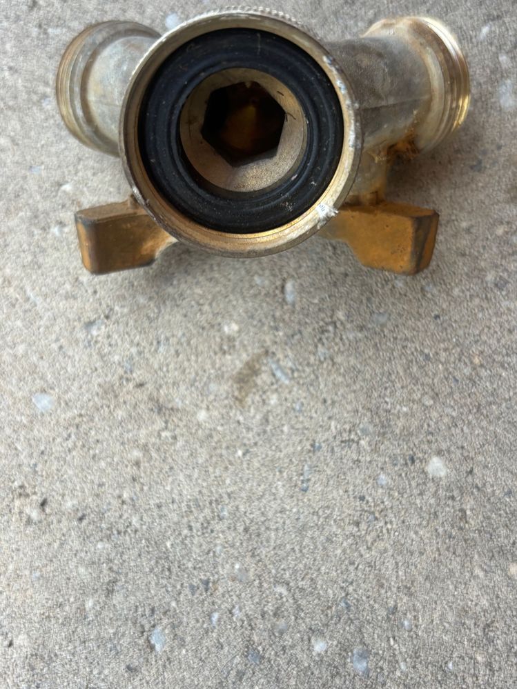

Now I need to have two hoses attached to the half turn garden tap how to fit a two way adapter on it?
Please see attached photos
Thx
Re: How to fit a two way adapter on half turn garden water tap
Hello @zillah
I suggest installing a Holman 12mm Double Ended Hose Connector and connecting a Holman 12mm Brass Sprinkler Adapter to the splitter. All you need to do is to push all three items together to anchor onto the new tap.
