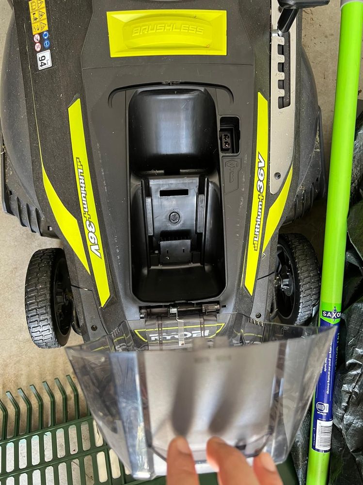

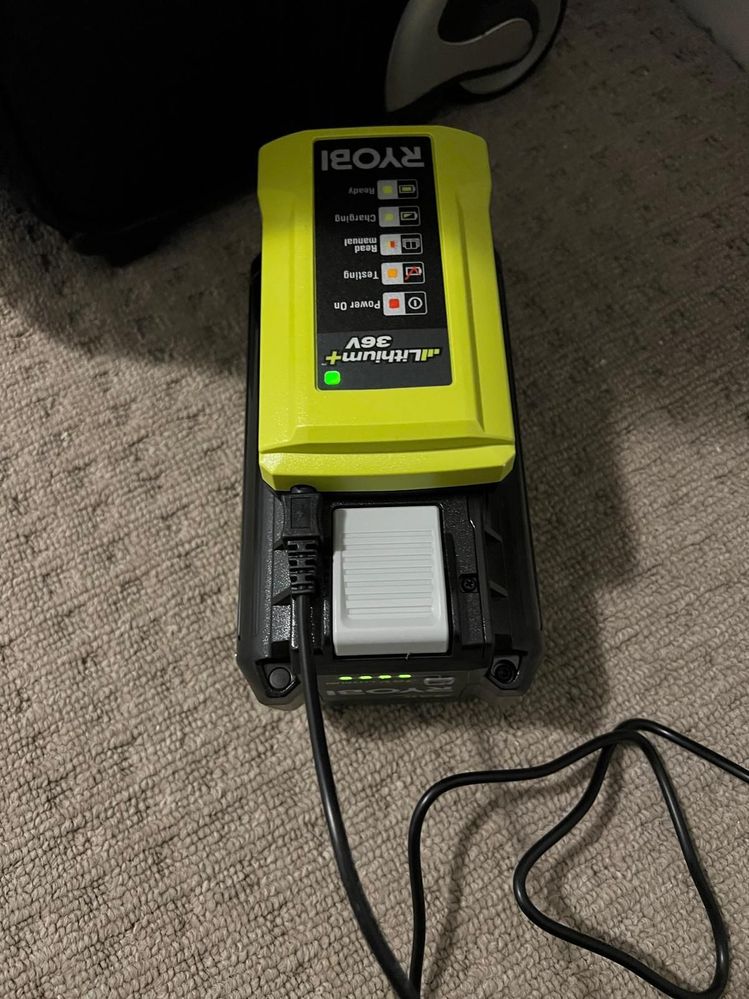

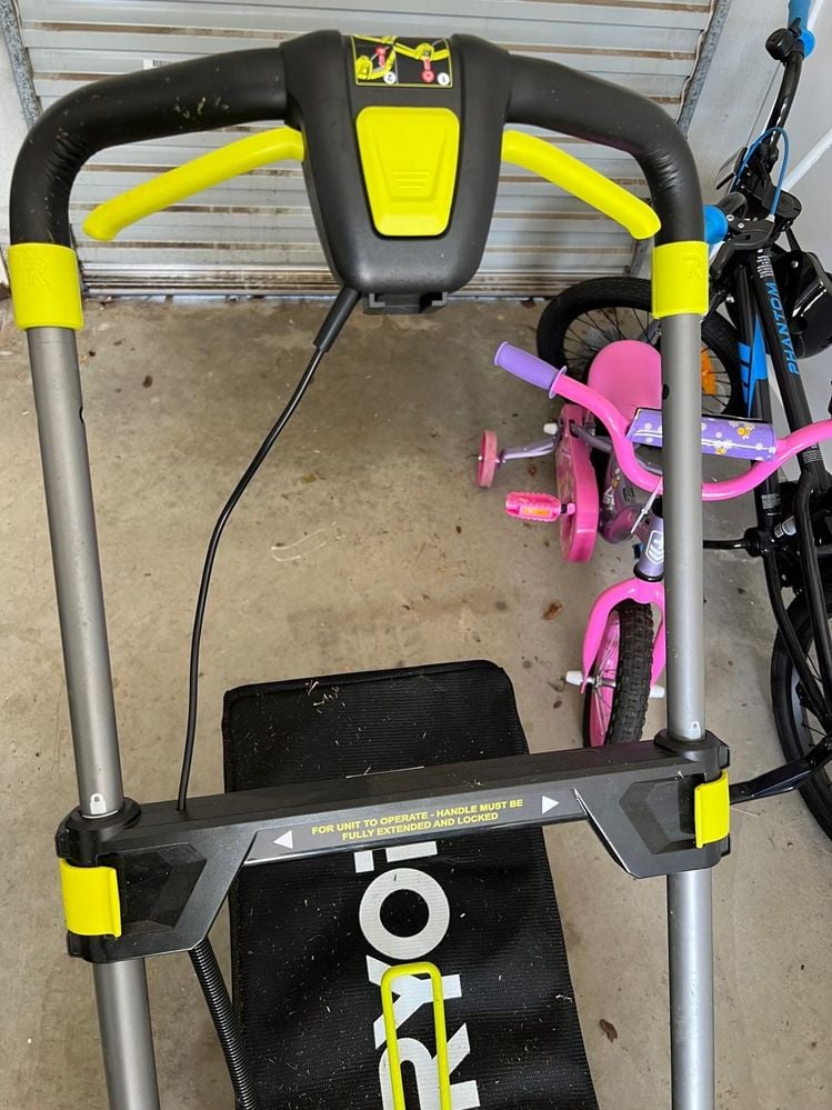

I bought Ryobi 36V 46cm Brushless Lawn Mower 4.0Ah Kit in August last 2024. It was going good but since February, it has intermittent starting issue. Although the batter is fully charged (attached in picture) but after keep trying to start, it just start once randomly and then refused to start.
I really appreciated if someone can point is it the issue with battery or issue with mower itself?

It looks like the battery and charger are functioning correctly, so there may be an issue with the mower itself, but it would be impossible for me to say what the issue is without being able to physically check the mower.

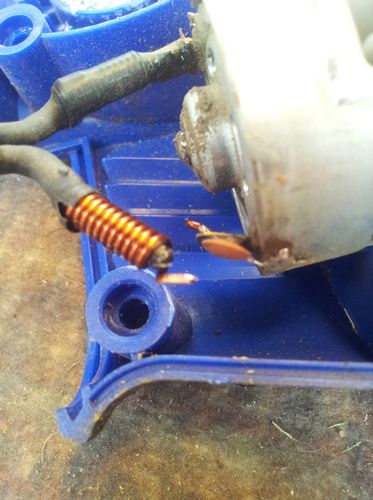

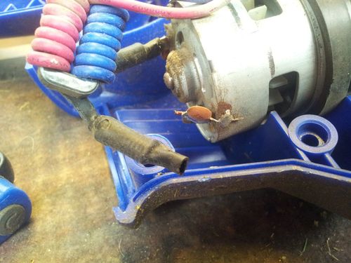

Here is one example:
While using one of my XU1 grass trimmers it suddenly died on me.
Took that to the worksop and grabbed the other one from the garden shed.
Later on here is what I discovered:
With the thing completely pulled apart I discovered one of the motor wires had broken off it's motor terminal connection.
Here is what it looks like.
Vibration caused that exacerbated (made worse) by the weight of the inductor inline with the motor connection.
The inductor and capacitor provide EMI suppression.
Sometimes the heat shrink sleeving will keep the (No 1) wire end in partial contact with the motor terminal (intermittent operation) or (No 2) comes adrift (dead motor). In your case the problem will likely be No 1.
