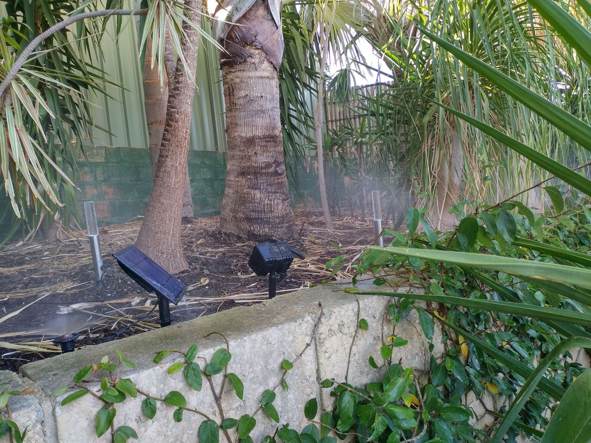

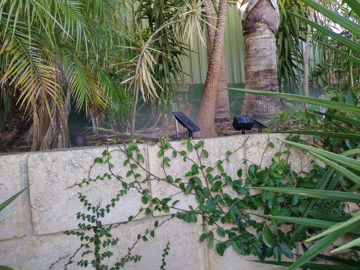

Scraggz
Getting Established
Re: Reticulation question
Difficult to supply a photo of the system working as it's kind of behind an almost six foot wall within about ten feet of the rear fence. The two attached are the closest I can get to it. I now have a couple of the risers to reposition as they're not clearing some of the vegitation.IMG_20230208_164538_HDR.jpgIMG_20230208_164513_HDR.jpg
