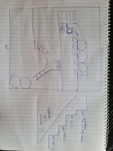

Hi @EricL and @Dave-1@Dave-1 thank you so much for your replies.
I'm attaching a sketch of my garden. Previous owners have temporarily tried to fix the erosion issue by stacking numerous pot plants where there is no retaining wall.
The soil is currently held by lots of fruit tree roots which are indicated by circles in my sketch.
I want to find out how I can stop the soil from sloping and eroding down especially on the areas where there are no retaining walls. It looks line the only thing that is holding the soil in place right now are tree roots.
🙂 Perfect timing! lol Your problem definently can be solved with some Gabion Walls 🙂 Serriously it looks perfect for some gabion styled walls as retaining walls. The reason I say perfect timing is that I have been prepping an area for a new gabion wall today. 🙂

I like your sketch! And it makes sense. It clarifys what it is. Do you want to keep it that way or modify it at all? I will be sketching mine up tomorrow tho I do have some "pretty sketches" of what I want. This is the first one with real measurments and spacings. Where I work out step spacings (width) anjd height of the steps plus height of the wall.

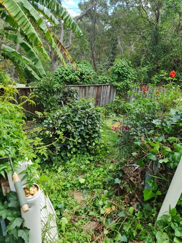

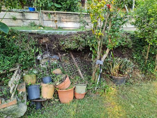

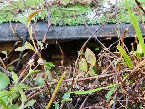

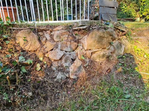

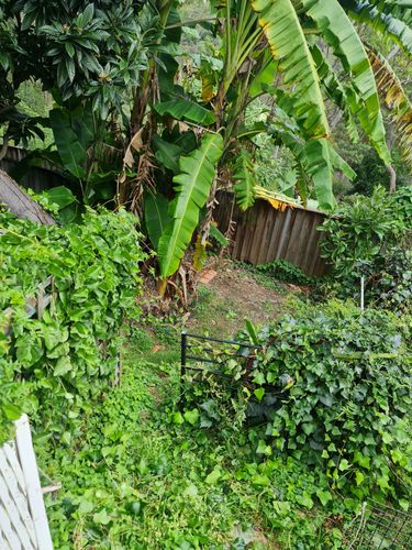

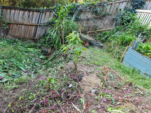

Evening again @jay66
You have a bunch of rocks that you can use I just noticed 🙂 Why lug them away if you can reuse them in the first place!
Thanks for sharing those extra pictures of your garden. It appears that a great deal of soil has been washed away and you can clearly see where the water has carved up deep channels in the soil. I think using a gabion wall as suggested by @Dave-1 is great way to control soil erosion.
However, I still encourage you to speak to your local plumber regarding the water runoff from your property.
