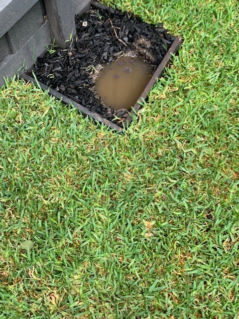

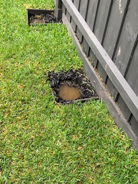

Planted a few trees in the backyard. A week into it the plants were dying. Uprooted all of them and realized that the soil and roots were soaked with water. Clearly there was too much water. Now I can see the holes getting filled up with water during the rain and its not draining at all. The soil is clay too. Any ideas to get the water to drain?
I was thinking of installing some Agi pipes right next to them and drain it towards the other side. Any advice is greatly appreciated.

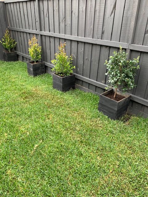

Hi @Adam_W, Thank you for that explanation. It was clearer than 15+ articles I read from all around. From what I can gather its a solid sheet of clay and its also pretty flat land. I broke rule #1 and planted right in a hole. I also did use gypsum, so you are right that it wouldn't help. I guess I dont have an option but to go with like a garden bed or a pots.

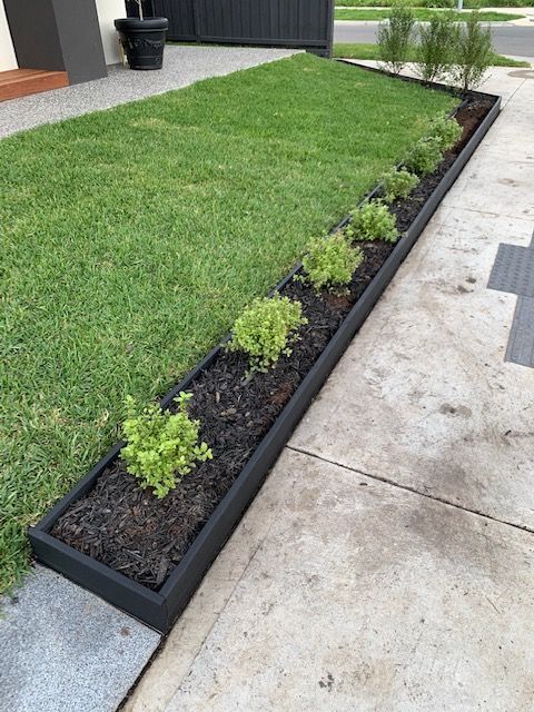

Ended up doing the same for the front too ![]()
Hi @Kevin92.
Many thanks for updating us on your solution! It's great to see you have come to some great middle ground so to speak.
What did you use to create the planter boxes as they certainly look the part and fit right in?
Thanks @MitchellMc. I am happy with the results and my plants aren't dying anymore! For the ones at the back I used standard treated pine palings, and of the front I used treated pine decking timber.
