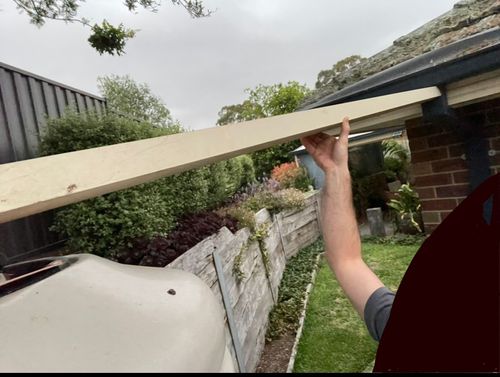

This is what i'm thinking - could anyone suggest the parts i would need?
I've already got one of these -
So i feel like i would just need 2 x square to round converters and then a piece of 90mm pvc to run to the tank?!?
Thanks
Yes, essentially you’ve got the right idea, @stuartheth. Two square-to-round converters and a length of 90 mm PVC to run to the tank would form the basic connection.
That said, any connection to your downpipes should really be done by a roof drainage specialist or a plumber, as it’s not typically a DIY job. They can make sure the connections are secure, watertight, and comply with regulations.
You’ll also need to include a leaf filter or strainer in the system. Without one, you risk sending lots of leaves and debris straight into the tank, which can quickly clog the outlet or pump. Some tanks have a built-in leaf trap at the top, so if yours does, you may be able to drop the pipe directly into that, but otherwise an external leaf strainer is essential.
Is it crazy to just stick a spare piece of down pipe in instead, bypass the existing all together?
