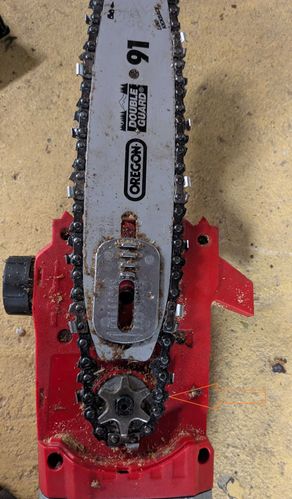

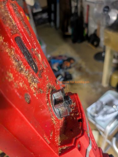

What I have (from pic above) is a star shaped sprocket, as viewed from the side. I have a groove where a locking pin goes, but no locking pin in place:
Maybe I'm just missing the locking pin, not sure, but I would bet there's a circular part too.

Sorry @denisl. Yes, I see that now. I thought you were referring to something attached to the side cover. That is a large washer and circlip and is definitely missing. If you see our Special Order team in-store they'll be able to put an order in with Ozito.
Thanks @MitchellMc ,
Special orders sorted me out. 18$ later, the pruner is functioning again!
