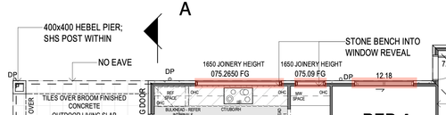

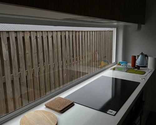

Hi Bunnings Workshop Community,
I'm looking for advice on how to improve privacy along my boundary fence.
I'm in Queensland. My kitchen has a window splashback (and there's another in the pantry) that looks directly onto the boundary, which has a "shadowbox" fence (photo attached). Cooking in the evening is uncomfortable because I can sense the neighbours looking through it. I have tried speaking with them, but I had no luck. They're renters, and the owner hasn't been responsive.
I would like a solution that does not require touching or modifying the fence, if possible. I understand that altering a boundary fence usually requires the other owner's agreement, and the process can be slow if they're unresponsive.
What I'm after:
  • A durable privacy solution that looks good from our side
  • Ideally, something that delivers results quickly
  • Preferably freestanding or not attached to the fence
Site details
  • Total fence length: approx. 18.7 m
  • From garage to end of alfresco: approx. 13 m
  • Garden section: approx. 5.7 m
  • Passage width: approx. 1.3 m (multi-colour gravel)
  1. Do you have ideas for tackling this project without altering the fence?
  2. If I do attach or alter anything, would I need council approval in Queensland?
  3. Any tips on what's compliant and practical for a shadowbox fence situation?

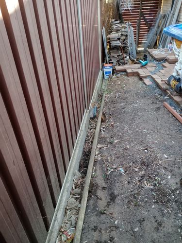

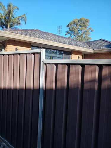

The second option is what I am doing down the side of my house where I am installing a spa. I want a privacy fence so when getting in and out of teh spa my guests or myself dont need to worry. I havnt finished the project but its part way along and looks liek it will work well.
I am installing posts every 1,100mm ish via earth screw stirrups and then bolting a post to them. the height of the posts are 2.4m to 3m as its a stepped slope with the fence. I will be only adding slats to the top 600mm as that is the section above the fence I need.
Side profile sketch of what I want it to end up (suggest you do the same as it really helps visulising space of the sidepath)

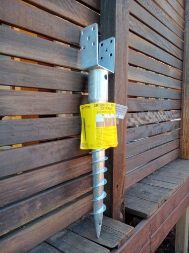

The earth screw

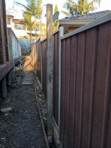

The narrow channel I want to have the posts in
The height of the fence when standing on the pavers... Yeah need it to be higher.

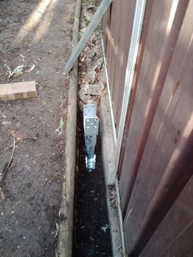

Earch screw going in, I did a center hole with a 30cm masonary drill bit to check for rocks. Not teh last hole I did I had to dig out as I hit rocks with the earch screw around the 35cm

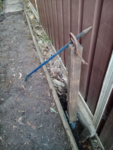

The eartch screw tools I used, so you need constant pressure downwards on the timber, G clamp across and a half turn with the prybar, then lift and twist and turn again. It worked pretty well but my muscles were screaming from outside normal use lol
How the post will look eventully, note. You need to leave the stirrups sides open so you can insert round headed bolts. Also not holding the weight of timber up so you can slide the bolts through the preedrilled holes is a little difficult.
Just one way to do a privacy screen without using concrete.
